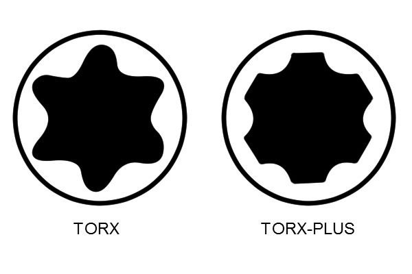

Really generic picture but gives you the idea

Is that torx plus the one with the hole in the middle?
