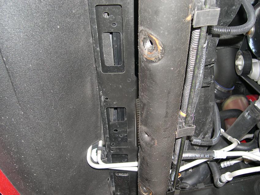

Just went out and looked at it and it will fit behind bumper no problem but won't have any airflow. If I had the new 09 bumper with slot in front it would work perfect.

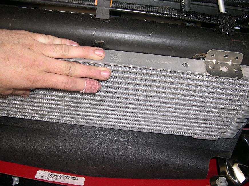

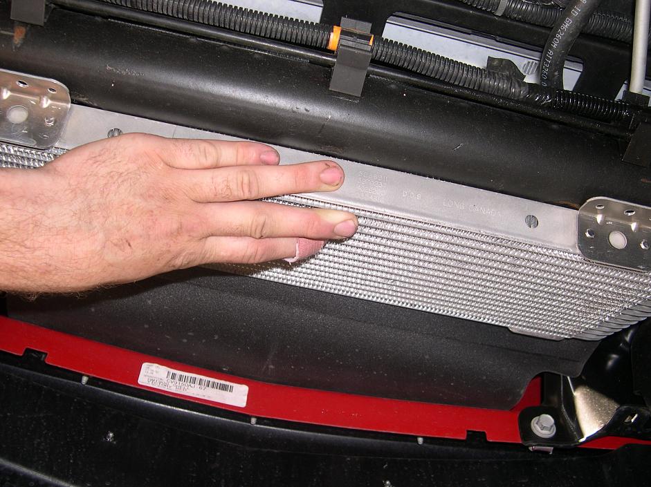

I have a main round tube that the front plastic skid plate mounts too. I was thinking about mounting it to there and then to bumper. It would sit at an angle and slop down towards back side of it. There is a rubber piece in there that attaches to backside of bumper and then to underside of radiator support. What happens if I mounted it where I said and then route the rubber piece under the trans cooler. I'm assuming it is just there to help seal the front side of radiator and condensor off so all the air is forced through there and not around it. Of course though if rubber was around backside the air would have no where to go. What if I just took rubber piece off. Air would have to be forced through there I would think. I'll try and take a picture of it holding it up there so you can see.

Here is the pictures.
