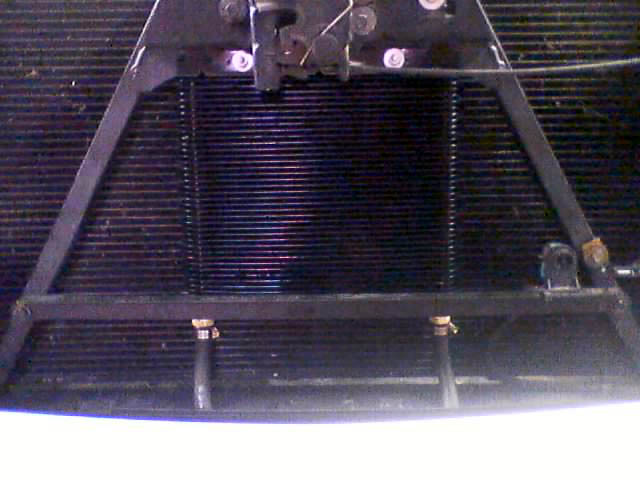

b&m or tru-cool 28000gvw...the bolt up and look factory...search for mine or quik ...quik's looks like the nice of the two

Here is quik's
And here is mine
My highway temps have went from 180 and above on the highway to just barely over 100 after the cooler install...i use an autometer cobalt tranny temp gauge with the sensor in the test port on the side... just to kinda give you an idea

I'm running the biggest B&M cooler they make, was bought for a mid 8 second street/strip f-body but ended up here. It has 1/2" fittings, using all AN stuff on it. Very nice setup.

wow i forgot i even posted a cooler pic. thats my old cooler on there. i then switched up to the larger B&M cooler that used 1/2"fittings and extended down a few more inches and i used a flex-a-Lite fan for cooling
