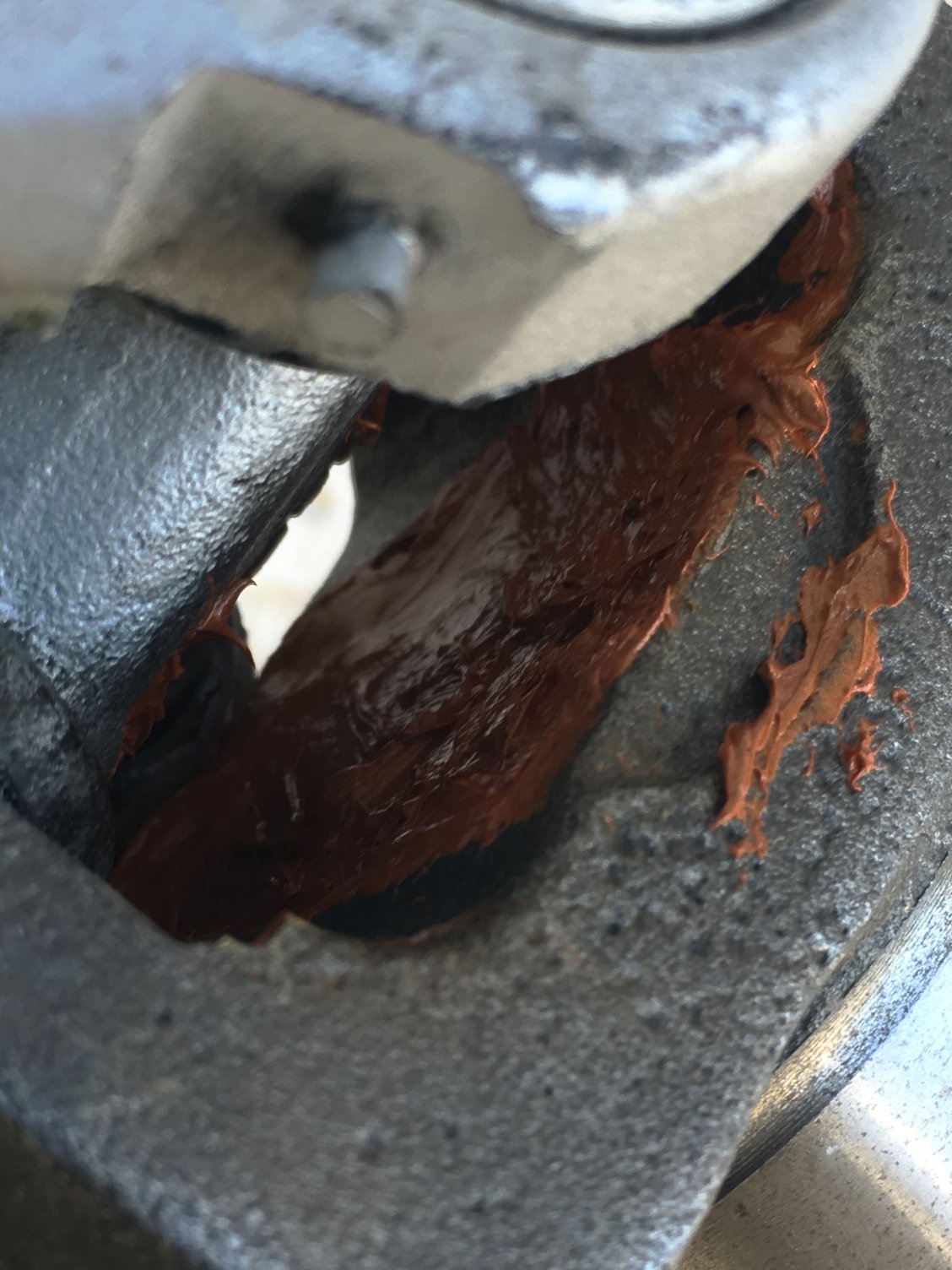

Can a 4l60e yolk start leaking ? Mines is leaking and idk if because the yolk is damaged . I replaced the extension housing seal and it still leaking .

For whatever reason is seems like it's stick out pretty far, but I could be wrong.
The new seal could be bad or maybe the yolk has a hairline crack in it????

Well it looks a lil out because the seal it had before would cover more of yolk , the one from autozone don't have rubber end piece .

Mine was leaking really bad after my 80e swap in my NBS. After looking over everything, looks like it was a leaky soft plug on the back of the yoke. I RTV'd the **** out of it, and it seems to have solved the issue. Ill be pulling it now and having it welded up, because the RTV is hideous.
