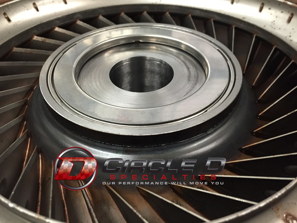

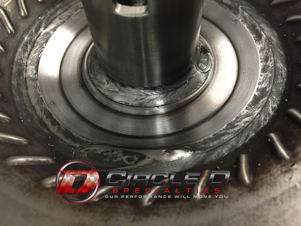

We do a lot of little extras to the 278mm to make them last in these heavy trucks. Most importantly is our balloon plate with built in bearing retainer. The most common problem on the 278 is the rear bearing failure due to shallow ID centering on the stator. We add our retainer on the OD of the bearing and upgrade to a 4L80 HD bearing. We implemented this mod about 3 years ago, virtually eliminating that failure. We also have the normal TIG welding, HD impeller hub, long life spun wound clutch and our CDS specs for stall options. Be happy to help you guys if you have any questions. 278mm is a great converter for the right setup, but some builds will require stepping up to the Pro Series Billet line.

^^^^ is more the reason i think circle d is the way to go!!!
