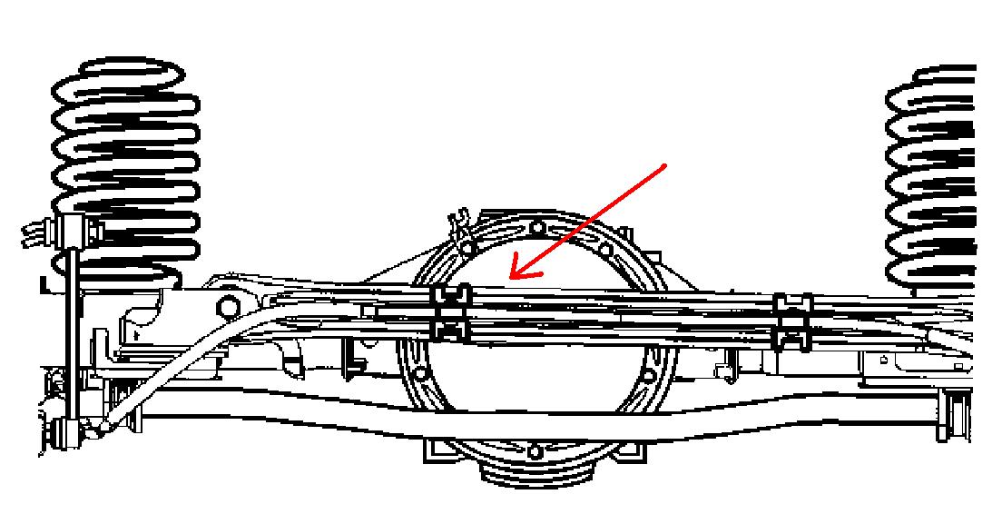

Does the track bar have a jog in it to clear the rear cover? The 8.6 track bar is straight and only clears the cover by just over 1/2".
Attached Thumbnails TECH:  6 Lug 14 Bolt SF into an Avalanche-track-bar.jpg

See post 28 for pics of my conversion setup. Here is a shot of it under the truck.
Edit: Updated Pic
