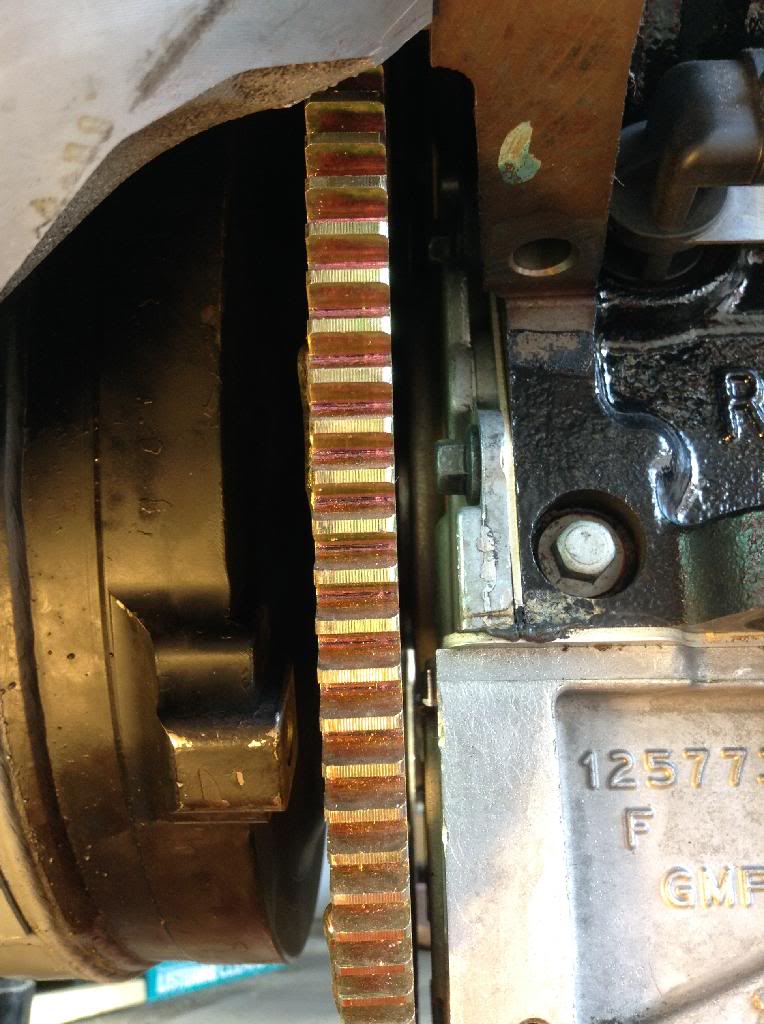

Well its not a bolt issue. My converter was not in far enough, and apparently I cannot count clunks! There is an entirely different issue going on involving too much space from the FP to the converter. Here is what I have:
2005 lq4/4l80e
Circle D 1a Multidisk
SFI three bolt pattern FP
With everything bolted together I am off from the pads of the converter to the face of the FP. Anyone have any ideas? Am i missing a spacer or possibly have the wrong FP? does not make sense to me...

clunks is not how you install a converter. there is a measurement that needs to be taken from the bellhousing to the converter pads. Clunks is how you ruin a transmission.

it also looks as though you need the spacers installed as well
