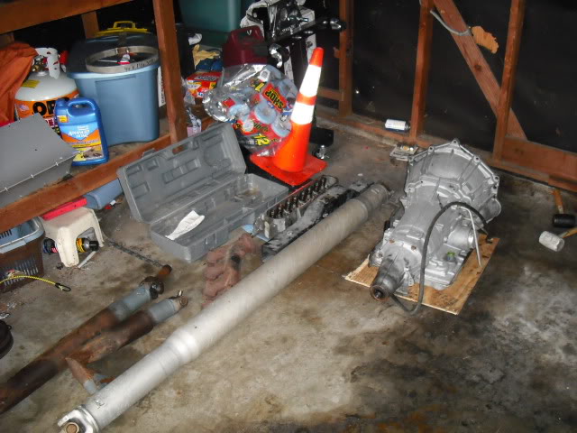

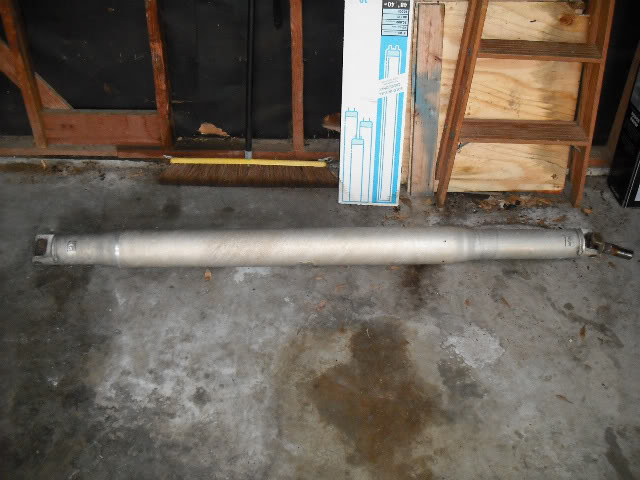

2 piece Steel is the only way to go for people like me and julien pushing big horsepower numbers in a 6k+lb truck with lengths exceeding 70+inches center to center
Our trucks came with huge 5in diameter .083 wall aluminum beer cans called driveshafts
(thats a 36" push broom in the background)
as you can see mine was twisted down it's length and was ready to fail

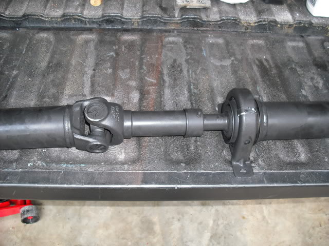

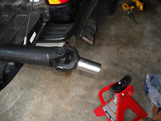

Here is what is replacing it
A Monster if there has ever been one
and all it took was this
and a whopping 2 hours of fab time and 4 grade 8 bolts
and now i have a D/S good to 1k+ hp with Spicer Hardened everything and a 1350 U-Joints

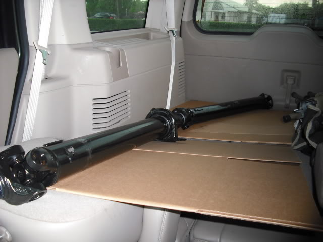

Another size comparison shot, thats my FLT 4l60e
