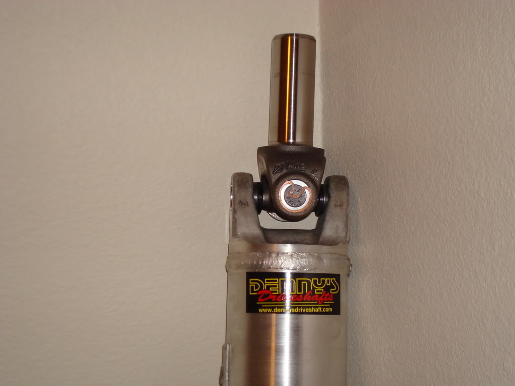

i've been there done that, broke a stock steel driveshaft and a "heavy duty steel" locally built driveshaft. had it with breaking tranny's and driveshafts so i called Denny's and he told me the only thing that would work in my app is Aluminum or Carbon Fiber, but he didnt sell those
Aluminum was 500
Carbon was 1000
i got a Denny's aluminum and it hasent failed me yet even blasts up to 140 or so, what is really a piece of mind is i get zero vibrations at any speeds during WOT

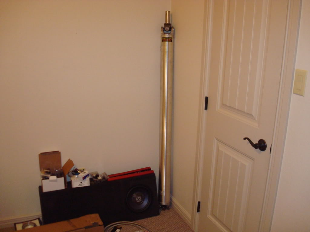

Thanks for all your help guys. I decided to go with a one piece aluminum driveshaft that will be custom built for my app. I also got lucky and found a case and tail for my 4l60e tranny for total cost of 120 w/shipping. Now i just need to figure out how I want the exhast done, finish the tuning we started and hope that everything works out. I am hoping for around 500rwt and about 385-400rwhp. I think i will be done for now, since I will forking aver another 3 or 4 grand.
