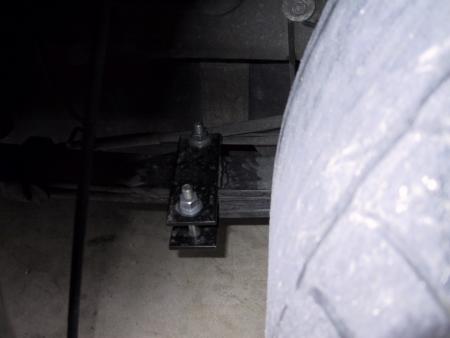

any one ever used the clamps on there rear springs that are missing the over load leaf..... if so how far forward did you install them
if pics are avalible please post them up if possible

Saw these quite a while back. I'll be making a set myself soon.

As far forward as possible mine are just behind the lil rubber stopper and I really like them they definatly stoped all the wheel hop in my truck and seem to get better traction its a great mod for the money.

so are you missing your over load leafs?????
Basically yea they are all clamped together like the pic above. I got mine thru Jegs.
