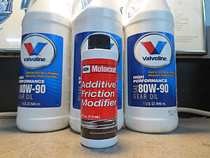

I've been using the F@&d stuff in my Yukon DuraGrip with success. My guess most all of the "friction modifiers" come from the same manufacturing plant. I do know one thing... if you get some on your clothes you'll have to toss them. If you get some in your hair or on your skin... no pootang whatsoever until the stench wears off
