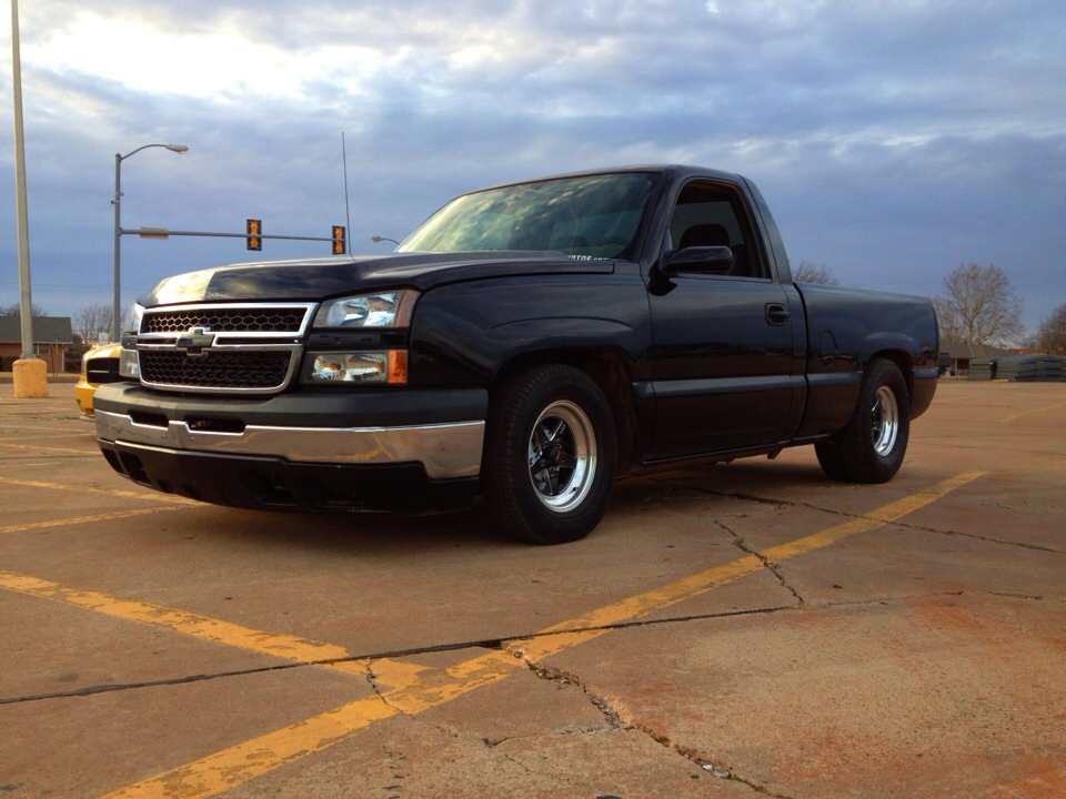

Stock hangers, stock shackles, removed middle spring, lowers around 5-6 inches

I know this is an old post but im liking your drop by just removing the middle spring. I have an 88 R10 suburban an i have been looking for a way to lower itwith out cutting the frame. this sounds like a must try.

Originally Posted by Phantom
Attachment 120715
Are you saying that by removing the "middle" leafspring that you achieved 5-6" of drop?
