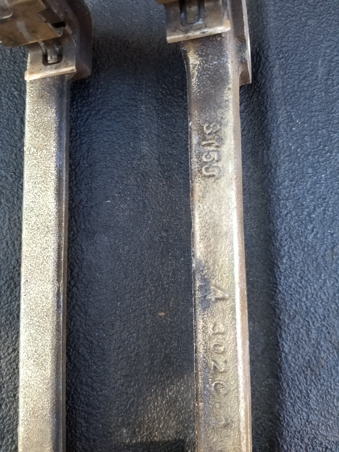

Here's a pics of what I have.
These don't have the pbr logo.
All the images I looked online that where like these have the pbr logo.
Could they be older model or knock offs?

Mine is the alumisport. Slightly different
