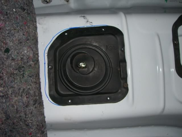

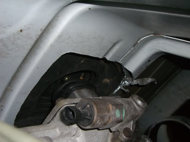

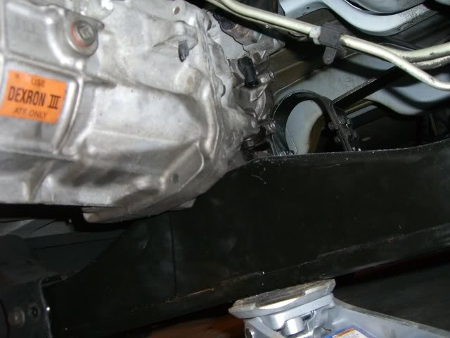

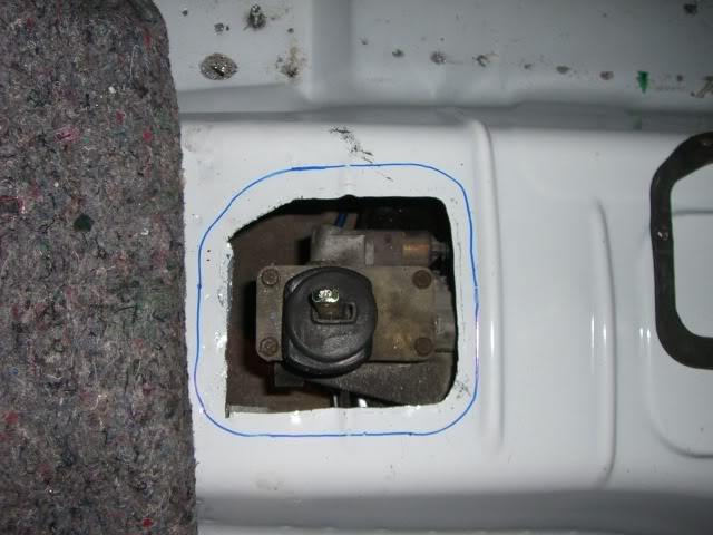

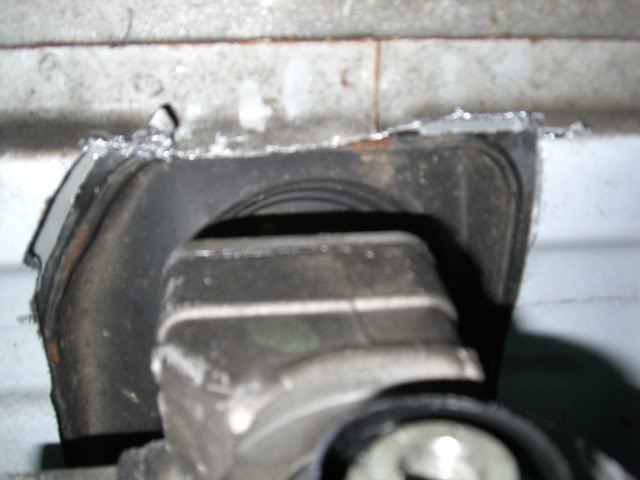

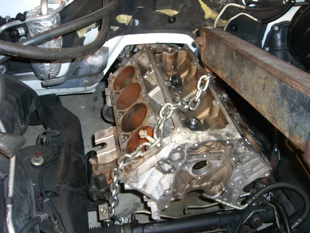

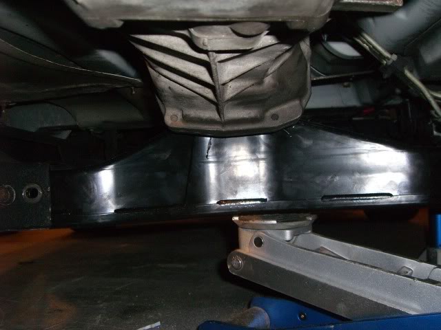

heres some more pics....this is a mock up trans and block. i still have some finish triming up to do on the underside of truck and hit it with some paint to prevent rusting...the rubber booty is from a fbody. also that is the a stock 5speed crossmember...i did all cutting from up in the cab area. tomorrow ill go and trim since i see i got some i need to show attention to

My tools & jack!!!

your tools, your jack, your air compressor, your parts and your garage....yes a big help!!!! and again all my parts come LSXperformanceparts.net or JJs automotive
