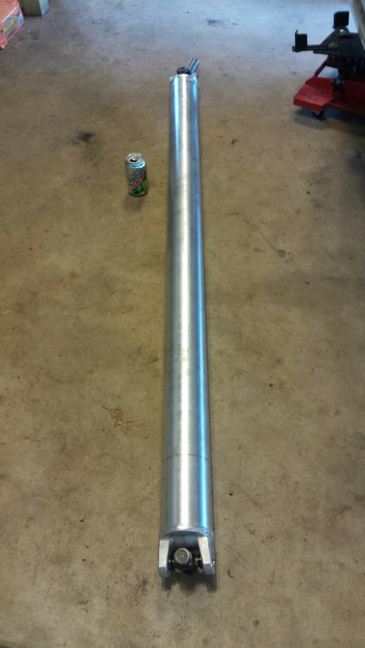

Originally Posted by rednekferlife101
What are your thoughts on steel vs aluminum for these trucks for the rear shaft? Took a quick measurement to see what ballpark it'll be in. Looks like it'll be around 66-67" long center to center of u joints. The stock one doesn't fit it is too long. Thanks guys!
Originally Posted by Wolftrk99
Steel is more rotating mass, aluminum is much lighter, that length you probably want to go with al for weight... I would send a request to a driveshaft builder... Mine is almost 73" and they are recommending a 5" aluminum shaft...
Mine is 4" .125 wall, sold through ebay coming out of california. $430 est. 69 and some change center to center for my Yukon XL 2wd. Got it in a week.
I hope they warranty that driveshaft for your desired RPM and Torque output. Good quality ones from the Driveshaft shop that we use start a $1,000.00 for aluminum with those specs, carbon fiber more which is understood. There are different grades of Aluminum and Steel so keep that in mind for what you purchase.
Old Jun 4, 2016 | 06:57 PM
  #49
iTrader: (87)
Joined: Aug 2007
Posts: 19,145
Likes: 8
From: Turnin' Wrenches Infractions: 005
Not to come off like a ********, but there isn't much to a driveshaft. Material, yoke, joints, and balancing. This is the equivalent to some other shops shafts that are more expensive, you're correct. My Camaro's PST 3.5" shaft was shorter, same quality, slightly better front yoke and it was $475ish and I think they've gone up. This one has the CAM yoke on the front (documented failures), which has always done well behind autos but has failed in manual cars that launched really hard. This will never apply to my yukon so no issue there. At the end of the day its as good as you're gonna get for the price, period. I did my homework. And, I've already driven with it and its perfectly smooth at hwy speeds.
Link?
This is who I bought through.
http://www.ebay.com/itm/272119530384?_trksid=p2057872.m2749.l2649&ssPageName=STRK%3AMEBIDX%3AIT
Here is the description.
THIS IS A BRAND NEW ALUMINUM DRIVE SHAFT
This Drive Shaft is made out of 4" .125 wall Alcoa Aluminum tubing (stronger Than Stock Shafts)
Comes with New Transmission Slip yoke and both New Spicer U-joints
Comes Fully balanced with U-Joints and slip yoke installed and ready for you to install in your truck
Fits : 2001-2006 Suburban and Yukon XL Models - 2wd only
REPLACES THESE PART NUMBERS
923836-1643M
15105506
Length of Shaft is 69-3/8" Center of U-joint to center of U-joint
Slip Yoke Specs
Spline Dia: 1.176
No Of Teeth: 26/27
Centerline To End: 6.750
Hub Dia: 1.500
Centerline To Washer: 1.000
Cbore Dia: 1.218
Cbore Depth: 0.410
Series: 1330
Series: 1330 - (1.062" CAP - 3.625" OUTSIDE LOCKUP)
Rear end has inside clip (3-R style)
Any question you can call
(661) 633-2303
