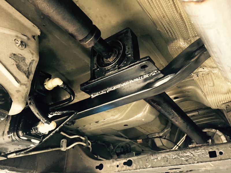

Anyone have any pictures of their 2 piece crossmember setup?

mine is simple. 5/16" flat plate 1/2" bolt holes with 2x4x1/4" tubing

Yup mine is 1" square tubing connected to each side of the frame with a piece of flat steel welded off the square tubing that the carrier bearing sits on

Here's how mine looks
