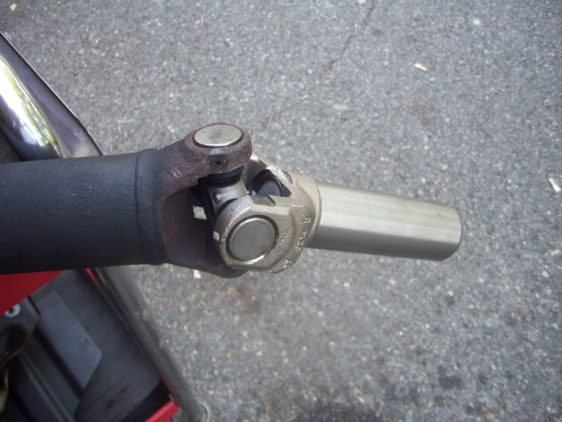

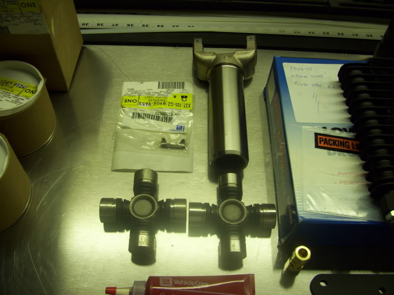

I don't think that installing a grease fitting into the yoke would be a good idea...aside from compromising the integrity of the yoke, that will introduce an area for trans fluid to leak out.
I replaced my yoke when I swapped my trans last summer and it cured the clunk that my truck has had pretty much since it was new. I payed less than $200 for the part with my dealer discount
