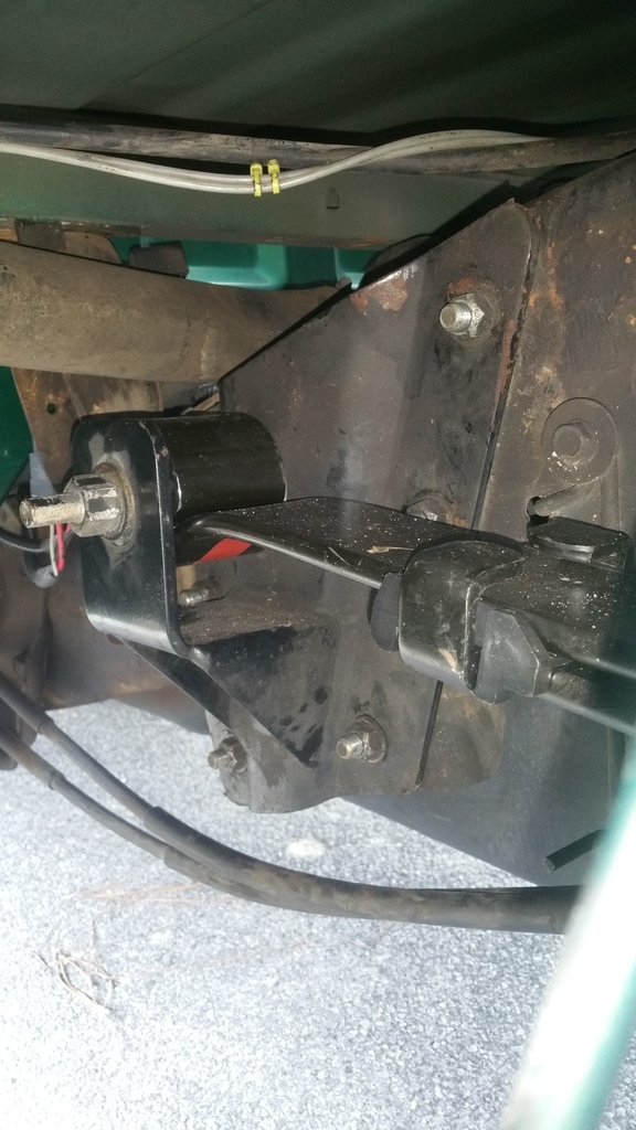

Here's some pics
lowest i can go now in the back
Ignore the alignment of the bed to cab its temp bolted down til i figure out what im going to do. But you can tell it needs another inch.
This is before the leaf change.

That's a bummer, those drop hangers only have 1 hole.
I had 2in drop on my hangers (2 holes) with 2 holes on the shackle to get a 4in rear drop.
Removing the overload spring or getting different hangers is kind of the only option. I don't think anyone makes 3in drop shackles and you'd likely hit the bed.

So I'm guessing my hangers are 1 inch drop and my shackles are 2 to make 3 overall and thats why I have shims between the axle and leaf to correct pinion angle. I guess I wouldn't mind changing my hangers to hangers that have two holes I never plan to go any lower. I guess having bigger arched leafs won't effect the handling much?
