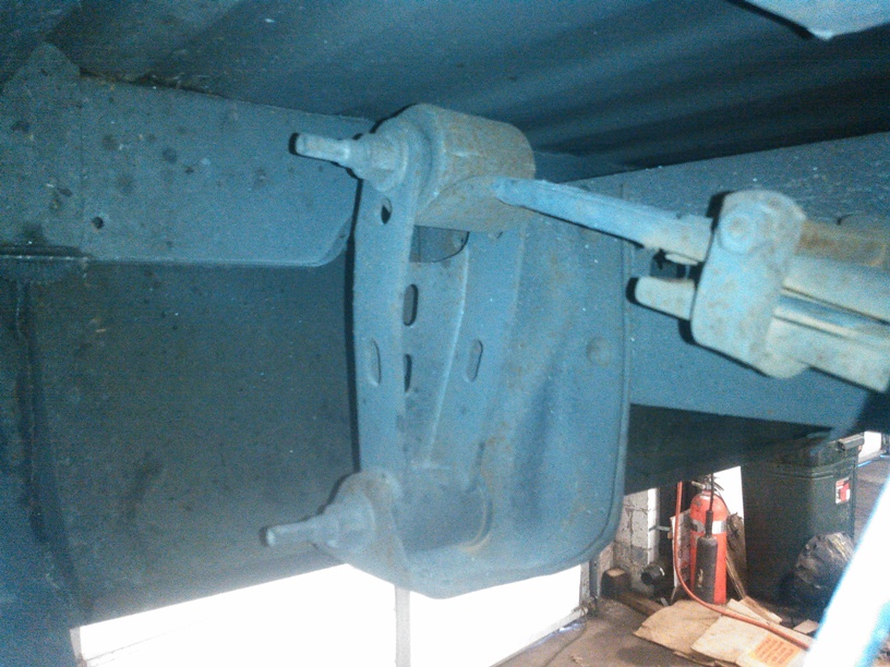

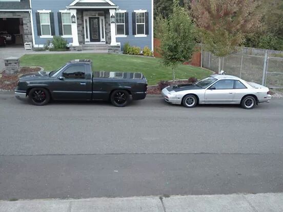

this is my 2005 silverado. it has a 5.3 air intake and flowmaster. i got it tuned by wongs in WA. i beat on this truck pretty good. then blew the 4l60 and replaced it with a preformabuilt 4l60. then blew the factory posi with 2.76 replaced with yukon gear and 3.42 im really happy with the truck so far but need new reaf leafs and away to prevent axle wrap and more suport in the back end. also what drop do you think i have from the pics thanks for the help

The long shackle isnt helping w axle wrap, but ot can stay w a set of caltracs. I like oem suspension w caltracs, or a flip kit w relocated rear shocks.

ok thats what i kind of thought. where is the best place to buy caltracs or ac similar product. also are those oem springs on this truck. i need new and was hpoing to get some from a junk yard.
