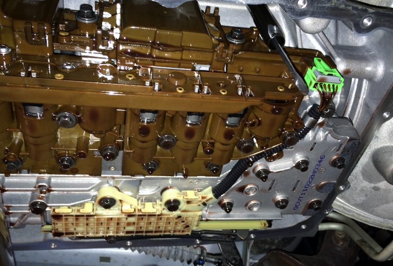

No TransGo reprogramming kit in the valve body this time. Black Bear tweaked the TCM to perfection:

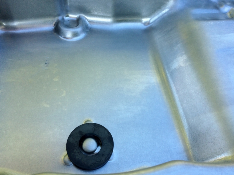

Pan had a very modest amount of clutch dust and only a little debris on its magnet. Whew. :)
Cleaned the works thoroughly and blew out any residual lint with compressed air:

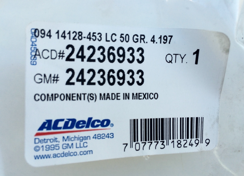

Replaced the OE filter with another AC-Delco piece. Same PN original filter was a NAFTA import, too:
