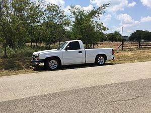

Hey all,
Just bought this truck 2 weeks ago, its a 2006 RCSB V8.
Really like it but rides like hammered dookie lol.
Already got the bed sprayed with Line X Premium and windows tined with Llumar Ceramic CTX film.
Previous owner installed a 3/6 drop. 3" springs up front and rear Flip Kit with DJM C Notch and Nitro Drop shocks.
I will be replacing the drop with the following.
McG's 2" Spindles and Belltech 2" Springs
Belltech Flip Kit and C Notch.
Belltech Shock Extenders.
Belltech Street Performance Shocks all around.
Im hoping I can replace the current DJM notch with the Belltech. The design just looks so much more robust. Plus the DJM one is already starting to show a bit of rust. Has anyone ever switched C Notch kits? Im guessing more holes would need to be drilled ;(
