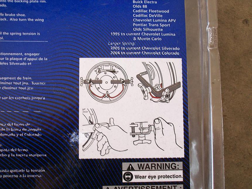

I finally got it done. what a pain in the A$$. I'll never do that again. I'll pay someone else to do it...lol. I don't know why chevy decided to change the way to mount the rear drum shoes. the old way was fine with me....lol just glad i finally got it done

I had to use the tool. along with a regular brake spring tool and two small pry bars. I will post pics of the tool up soon. the cost was only $36. it also helped when a friend of mine stopped by (the extra set of hands was useful)

here are a few pics of the tool

Man, that's a heck of a contraption just for a brake shoe spring lol. Looks like it works well though

yea it worked good. don't know how i would have done the job with out it...lol

I did one like that for a freind recently , I had never seen that set up However after about and hour screwing with one side I figured it out no special tool but i could never explain it, Did the other side in just a few minutes does take a little muscle though.

I found this tool at SJ discount tools for $34.00 shipped.
Part #LIS50600
