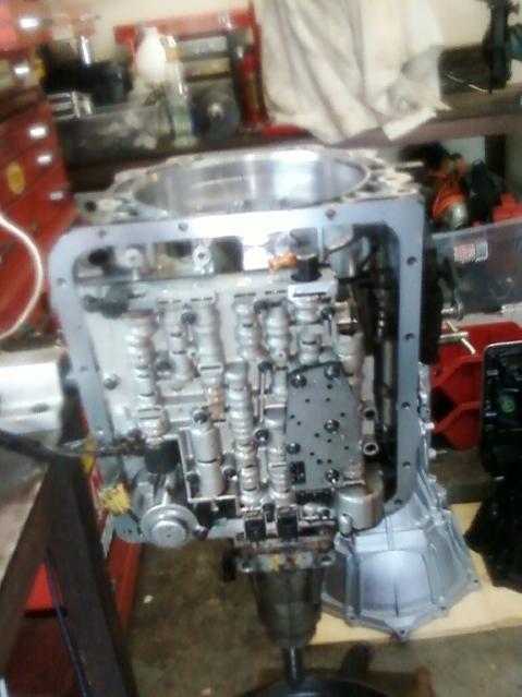

Default Just some pix sent to me by the builder
Just a few pix of my tranny tore up.
From what was discovered no seals have ever been replaced, just the clutches. The pump came apart too easy. Luckaly my servos where in there. That rules out that they just went to a junk yard and put that in mine. The transmission was the blackest he had ever seen, no red tint to it at all. There was silicone in the trans as well(not a good thing)

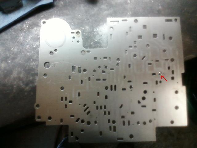

Default Failures
Aside from the first problems mentioned, there was a stuck check ball. Luckally a bought a new separator plate with the rest of the parts.
