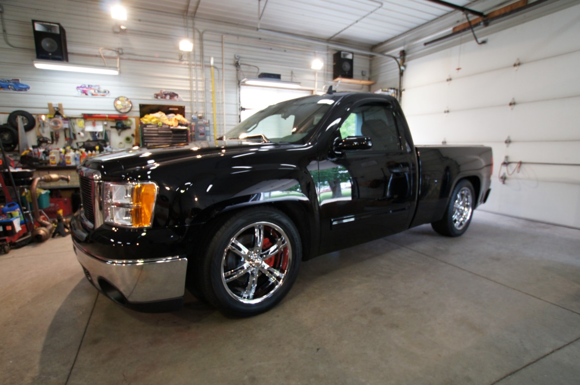

I put a 5/7 drop on my 2011 GMC and I updated the front struts with a Belltech adjustable strut. I did this since McGaughy's did not have the adjustable ones that they have now at the time that we did the work. I also put in the camber degree kit that Bell Tech sells to get the front wheels back to straight. The truck has 70,000 miles on it now, most of which were with this drop on it. You will have to cut open the rubber fender liners at the top of the fenderwell to gain some clearance and then seal them to the sheetmetal above them. I also downsized my tires to a 265/50/20 to gain a little more room. Handles well and the ride is not any more rougher than the original ride height.

The McGaughy's drop kit uses the factory struts and they supply their own brand of shocks for the rear. I changed out my front struts for a set of adjustable struts from Belltech, that were made for a drop and also have better valving in them than the factory struts. I changed the rear shocks out for a set of Bilsteins shocks that also improved that problem. The bump stops on the rear were changed out for a set of Timbren absobers to ensure that I had a good sized bumper in the rear and now when I want haul anything that is heavy, I also put on a set of McGaughy's air bags for added support.
The truck is now well over 100,000 miles and handling just fine.

This truck is lowered with the McGaughy's 5/7 drop. We did the notch to get clearance and it rides fine. As I stated, the factory struts and McGaughy's shocks did not work as well as I wanted them to.
