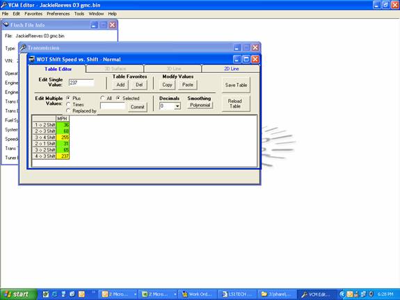

Was wondering if any one knew of a chart, that shows what the factory settings is for trucks, maximum speed/Rpm for each gear for different diff ratio. Ive checked my GM Shop Manual and Owners Manual and I can find them.
The reason why Im asking is I was playing around with the hypertech this morning, changing shift points, but all it shows is +/- 1MPH, Ive calucated it out where I would like each gear to shift, but need a baseline for each gear so I know how many MPH to add.

Thats what I have already done, I have figured it for each gear. But what I need to know is what GM sets the shift points at in MPH for WOT for each shift. Thats why I know how many MPH I need to add. The Hypertech does not show an actual MPH you can only add or minus the MPH in 1MPH increments.

ahh I see, sorry didn't think of that. I'd just make a few stock WOT runs and see where the 1-2 and 2-3 shifts are at and go from there.

i could'nt post it in the screen but here are the factory shift speeds at wot for an 03 gmc

pic doesn't show up....

fixed it

jsut put in 1-2 +4 and 2-3 +10 leave 3-4 at 0 with a max speed at 128 that will let you shift from 1-2 at 6100 and 2-3 at 6000 shift firmness on. I put these setting on my neighbors 04 ecsb 5.3 and he ran a 15.10 at 92 mph in 45 degree weather.
