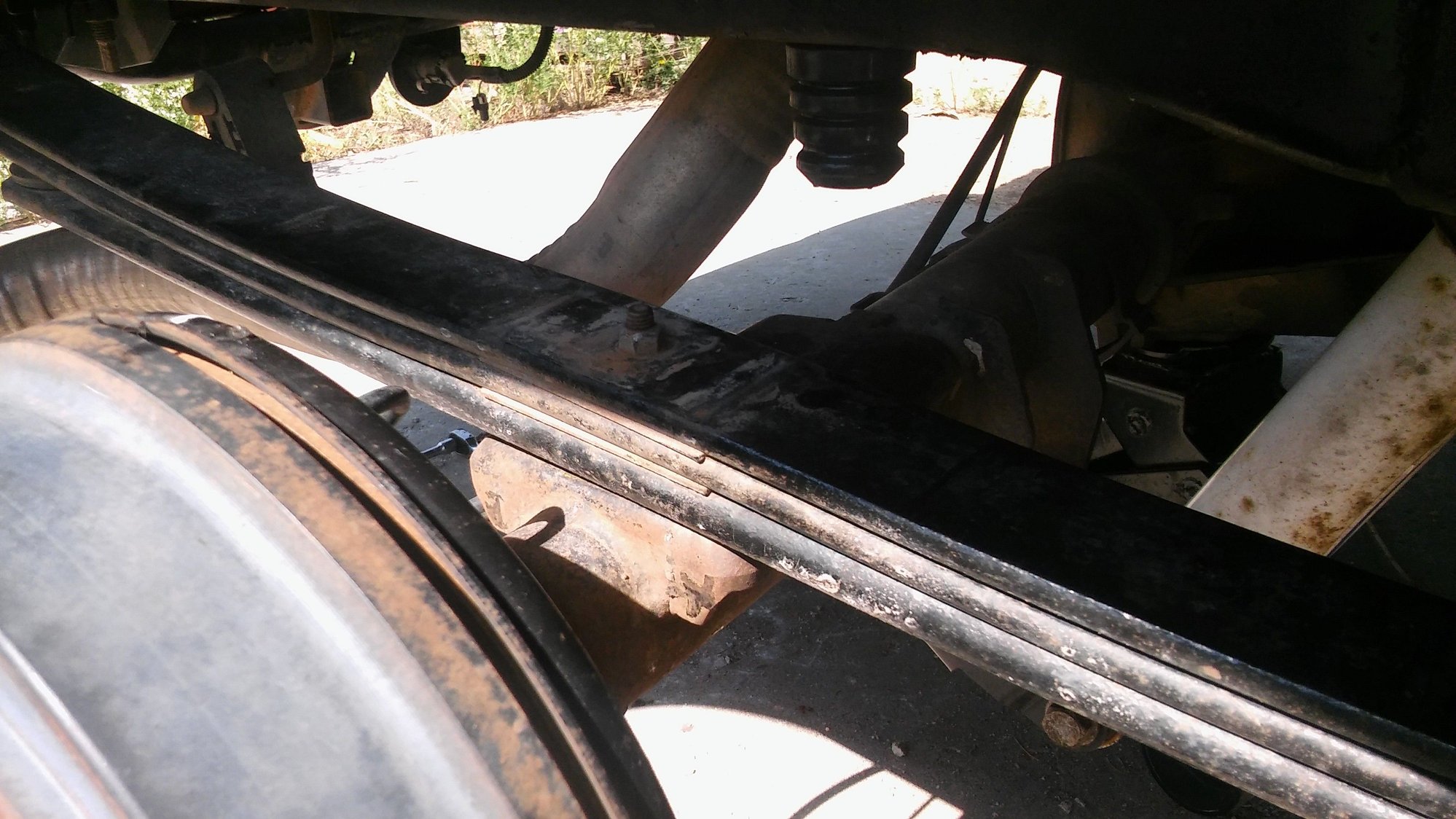

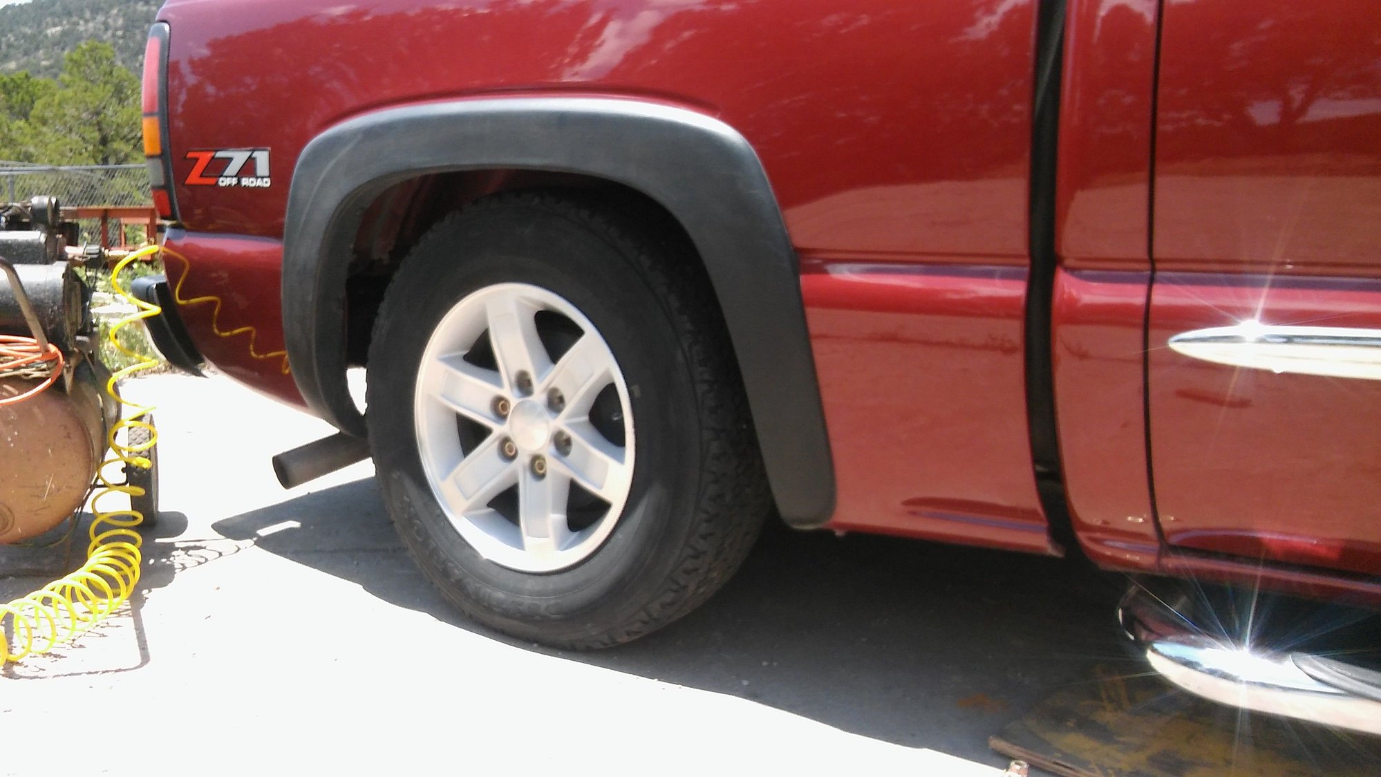

Anyways- this is what the passenger back end looks like, resting on the bump stop almost as if I don't have a leaf spring. I'm gonna go take the spring off and look at it. Any body have any input it'd be much appreciated..... TIA

Pick the truck back up, loosen all the shackle and leaf spring bolts, lower the truck back down, maybe even take it around the block, then snug them back up. Do not overtighten them. Everything you installed may be binding up.
-or you could have a weak leaf spring you never noticed before.

Weak spring, that's my biggest fear, can't believe it because I hauled a couple good load of dirt a couple weeks ago; pretty sure I did everything fairly loose as to allow movement and all. This evening I took the spring off to look at it, verify no cracks or any of that. I think I'll swap sides and see what happens. If it still sags I'll know it's the spring and put the new one on drives side. I mean it really looks good if it didn't sag out one side.........

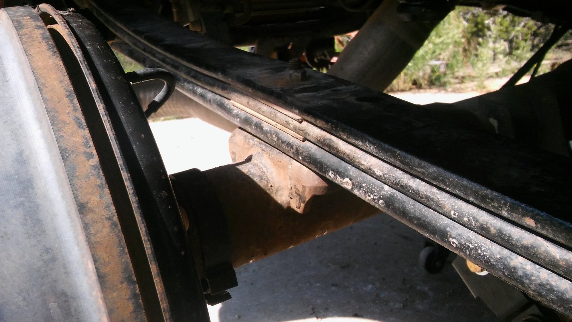

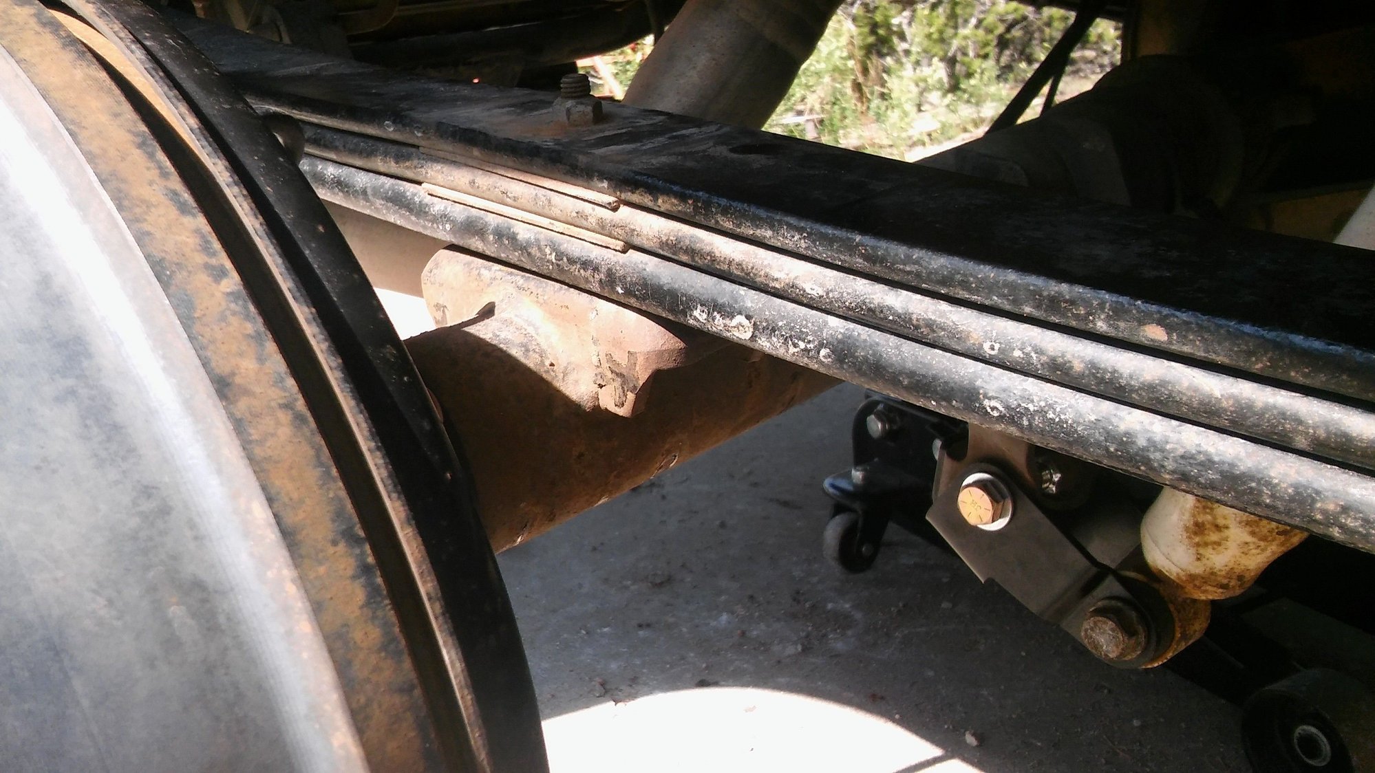

Hey guys- think I found the issue. I put everything back; spring over axle just for kicks to see what I might find- here's some pics. I think it's time to accept the fact that the spring is history, see the S'ing.........
"FK u....I'll just dearch myself"
That's what it said.

Weak springs happen. I've seen quite a few of them on the 99-06 trucks. I'd hit up a junk yard and snag a low mile set out from under a V6 truck. Not all the springs are the same rate.
