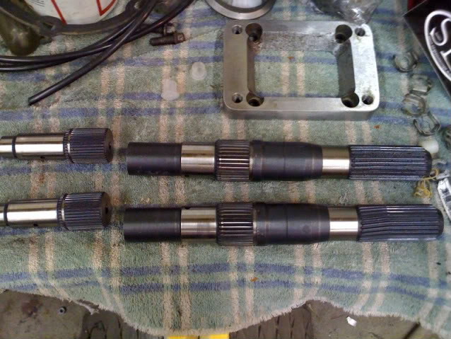

Don't waste your time with a stock 4x4 out put shaft, get the 300m billet one. I broke 2 4x4 out put shafts on my built 60e before going to an 80e
At what rwhp/rwtq did u break the two shafts?
To my knowledge, 4WD trucks have the 4L65E which comes stock with hardened output shaft. Correct me if I'm wrong.
Another solution is to cut the 2WD billet output shaft that came in the RPM Trans and have new splines made at machine shop.
Those ARE the 4l65e 08 tbss shafts! lol Bought the first one new from GM and the second was a "warranty" replacement of the first, . You won't be able to re-machine the 2wd shaft, they are WAY different. This was with my forged LS1 masterpower t76 and about 550-600 hp. 4x4 boosted launches are not there friend!! lol
About half way down the page. It's expensive, but it's the only piece I kept breaking in my 65e
