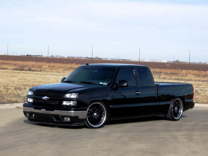

Definitely get a notch if you use a flip kit, whether stock or lift shackle. I bottomed out plenty with a 2/4 drop no notch. These aren't like NNBS trucks that can get away with it.
my old truck was 2" spindles, 2" springs (trimmed some coil to make it 3.5" drop), flip kit, lowering shackle, notch, helper bags, carrier bearing kit and shock extenders. Make sure you get good shocks and it will ride "fine". It's still a slammed truck, but I think it rode better than most stock trucks because I personally am a sports car guy and I hate the floating that most trucks have. I want responsive suspension that handles the road
