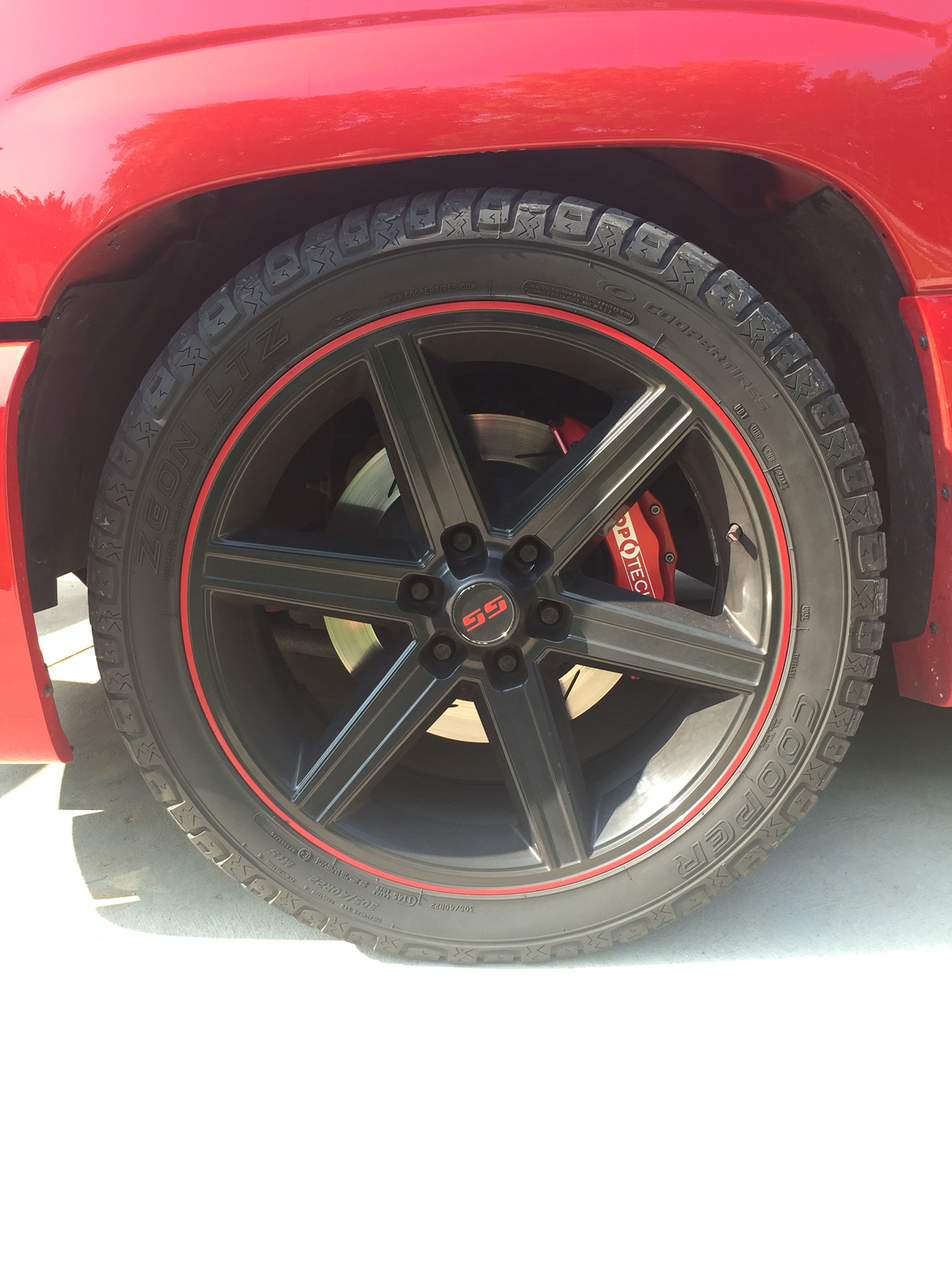

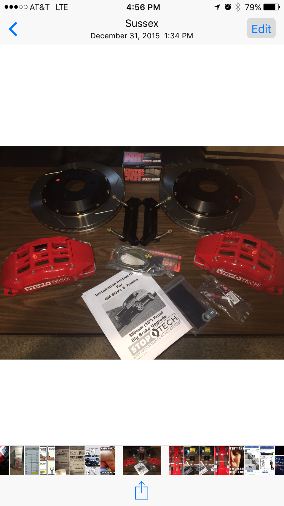

lOOKING TO DO BRAKE UPGRADE-photo355.jpglOOKING TO DO BRAKE UPGRADE-photo168.jpglOOKING TO DO BRAKE UPGRADE-photo696.jpglOOKING TO DO BRAKE UPGRADE-photo313.jpglOOKING TO DO BRAKE UPGRADE-photo29.jpg
I don't know about that Atomic. My brakes are pretty good. And I can get them cheaper than anyone else.
