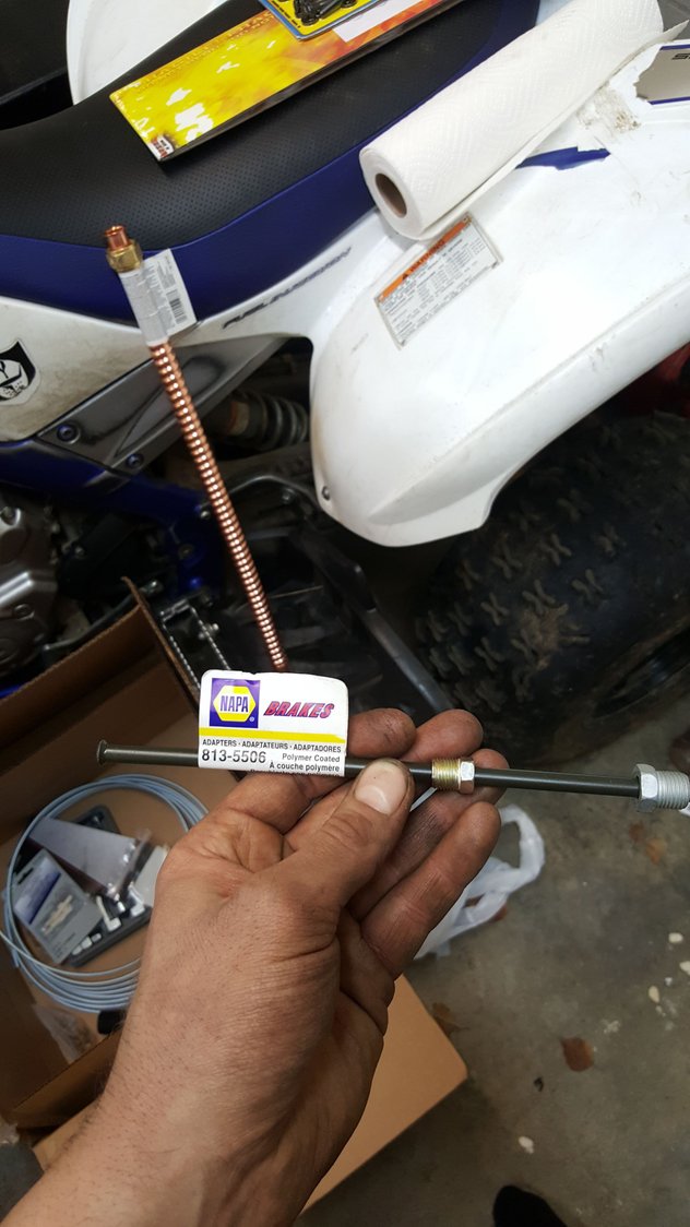

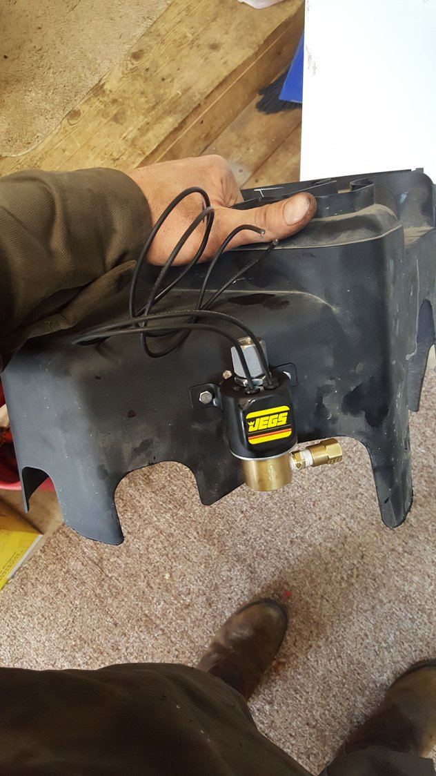

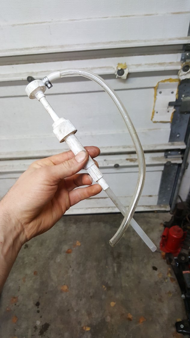

So I got a wild hair up my *** and decided to install a line lock on my truck, and boy what a difference it made, before I couldn't break the rear tires loose AT ALL, now it'll start smoking em before half throttle. I decided to install mine directly after the master cylinder, blocking psi to the rear. The lines are 1/4" and the fitting in the master cylinder is a 1/2"-20. Napa sells nifty little 1/4" break tube adapters, which made going from 1/2-20 to the 1/8 pipe thread on the solenoid a breeze. Took her out for a test run and it works great, no ABS light. And just a tip if you do this, instead of trying to bleed the air all the way out from the master cylinder to the rear brakes get yourself a bottle pump, like one for filling the lower unit on an outboard. Hook all you lines up and pump oil in from the bleeder on the caliper, just pump until you see the level rise on your fluid reservoir. Just have to be careful to have the pump line full of oil so you don't shove a bunch of air in.
