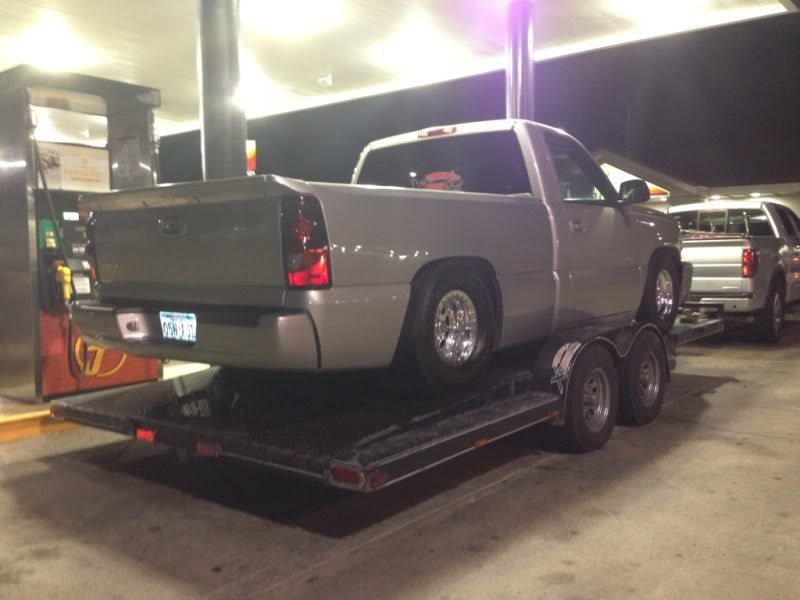

I really haven't done much weight reduction. The way I have been taking weight off my truck is by replacing my stock parts with aftermarket parts such as my Wilwood all around billet 4 piston caliper brake setup and my rear 4 link setup. On my 4 link its a custom kit our local chassis shop built for me. It's an awesome kit. I will take pictures of all my setup and send you pics. On my fuel cell it does not hang past my bumper so it can not be seen unless you crawl under the truck. Here is a quick pic of the rear of my truck on the trailer.
