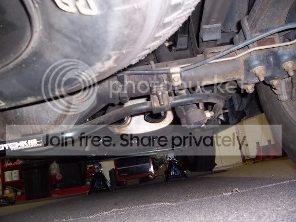

Like stated, I need to see some pictures of rear Hotchkis sway bars on a 2wd/NBS/Lowered truck.
I'm wanting to see where they bolt up... Possibly they will fit with my 4 link setup and I could just buy the front/rear kit...
If you have pictures, please post them. Thank you.

dont know if it helps but its all i could find
look at that gap

Hey, maybe you could tell me where the ends bolt on to. If they hook on to the leaf springs in some way, this is a no go.
Also... The sway bar is mounted infront of the axle or is it behind it? My coil overs are on the rear sooooo. I need to know.

Originally Posted by Sport Side
Why are your tires so small. LOL
Also... The bar is mounted to the front of the axle or is it behind it. My coil overs are on the rear sooooo.
less tire to clean? LOL
theyre mounted to the frame
I think I got a clip from underneath
let me see if I can find it

all right

That **** may fit. Sweet. Love you btw, thanks for the pics.

The rear bar attaches to the rear axle next to the shock mounts. The bracket (centerline of the "dogbone" bolt) attaches to the frame roughly 16" ahead of the centerline of the axle. (These are pictures of a standard height truck, on a lowered truck the dogbones are shorter)

thats exactally how mine look, cept my endlinks are shorter
front bolts into stock location cept with new poly mounts (same location)

The kit then that you purchase must meet the drop that you are using? Different dogbones for different drops or what?
