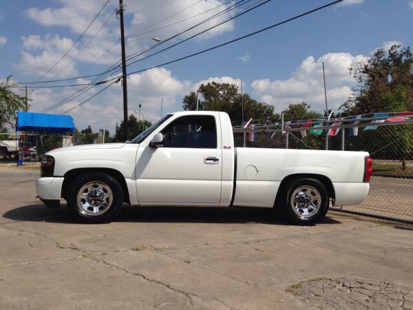

I have a GMC Sierra with 3 inch drop springs and flip kit on the back
Truck rides rough!!!
Anything I can do to help ride???

Checked the pressure there at 40psi Im riding on 265/60/17 Goodyear rsa tires.
What about shock extenders or what brand shocks are good for drop trucks I currently have
Belltec drop 2 shocks.

Those shocks are your biggest problem. Get some good shocks on there and you'll be much happier. The Belltech shocks ride like bricks! Some Bilstiens that are the right length will be night and day different.

+1Bilstiens, really helped my stock ride height truck.

Anybody know of bilsteins that are the correct length for a truck withat a flip kit and shock extenders?

And yes like 1bad2k said does anyone know the length shocks I would need for a 3/5 drop??

Is it 2wd or 4wd?
Best way to figure out what shock you need is to get under there and measure the length it sits at then compare to the brand catalogue.

It's 2wd
I'll messure the front and rear tonight see the length and get some order, I'll post before and after pics. do shock extenders help??
