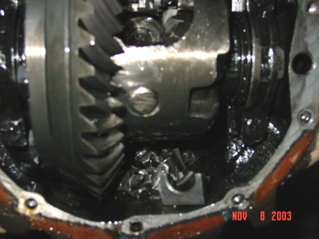

Originally Posted by moregrip
that didn't look like much, it grenaded? did it take anything out?
it was a lot. pm him for some pics of his rear end when he took it apart. chunks of metal were everywhere. the gears actually survived but the g80 looked like a bomb that threw a bunch of shrapnel everywhere when he took the cover off.
damn, what year is his truck?

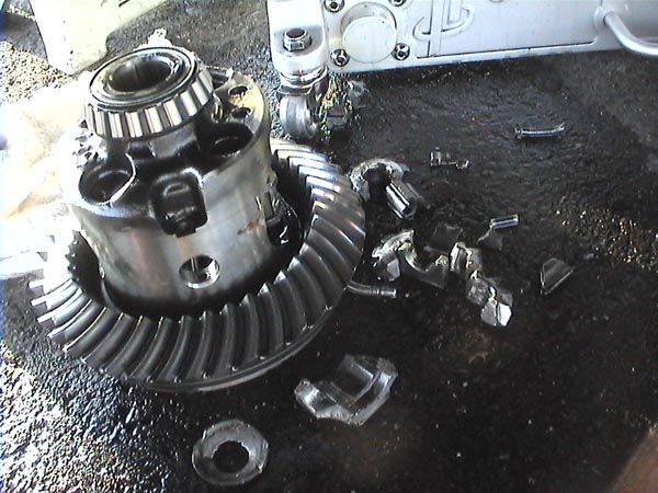

I completely demoed the carrier. All the spider gears were in pieces, bent the center pin and cracked the carrier housing. Fortunately none of the shrapnel got logged between the ring and pinion so my gears were fine. I will put some pics up when I get home.
Here are a few pics...
