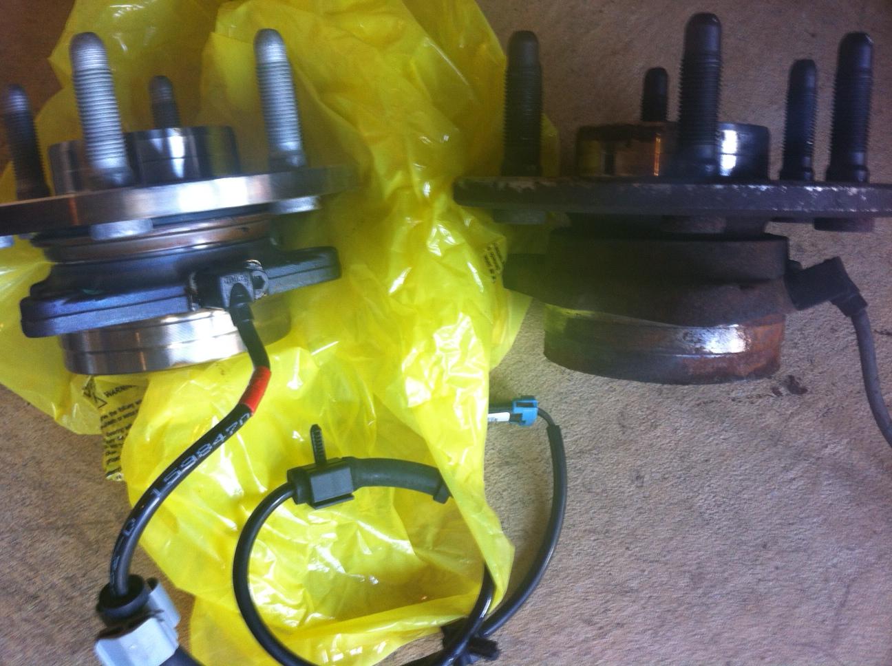

I got timken assemblies. You'll need either a big 35mm or 36mm socket with breaker bar if you don't have an impact gun. I got all parts from Amazon.

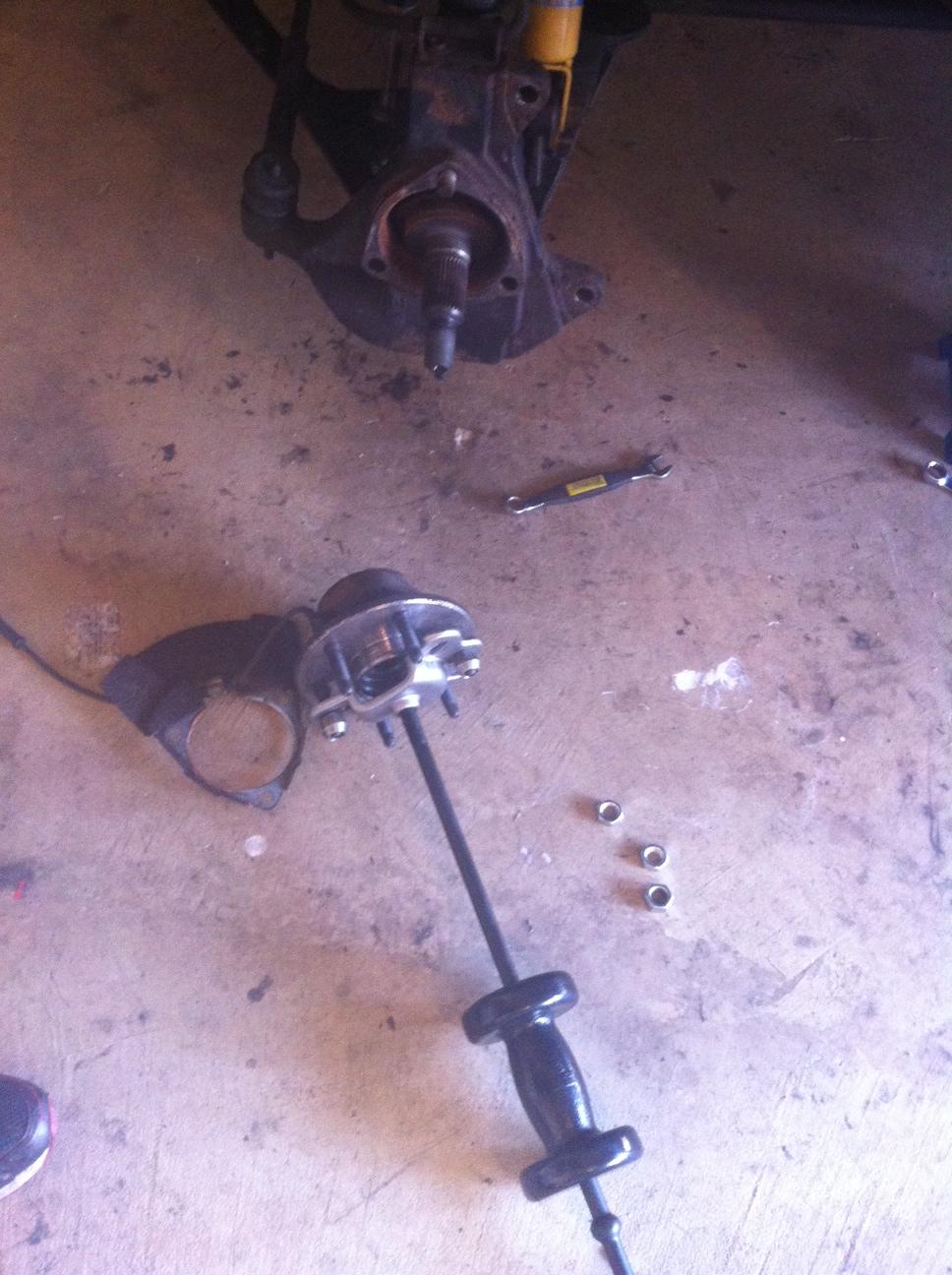

You better have a big slide hammer.

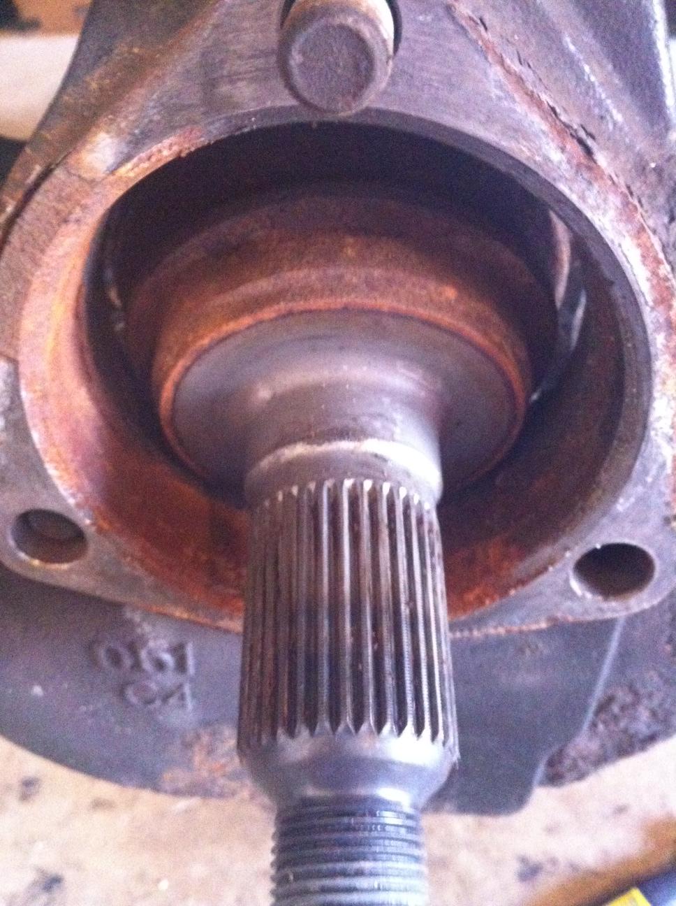

Rust seals things in.

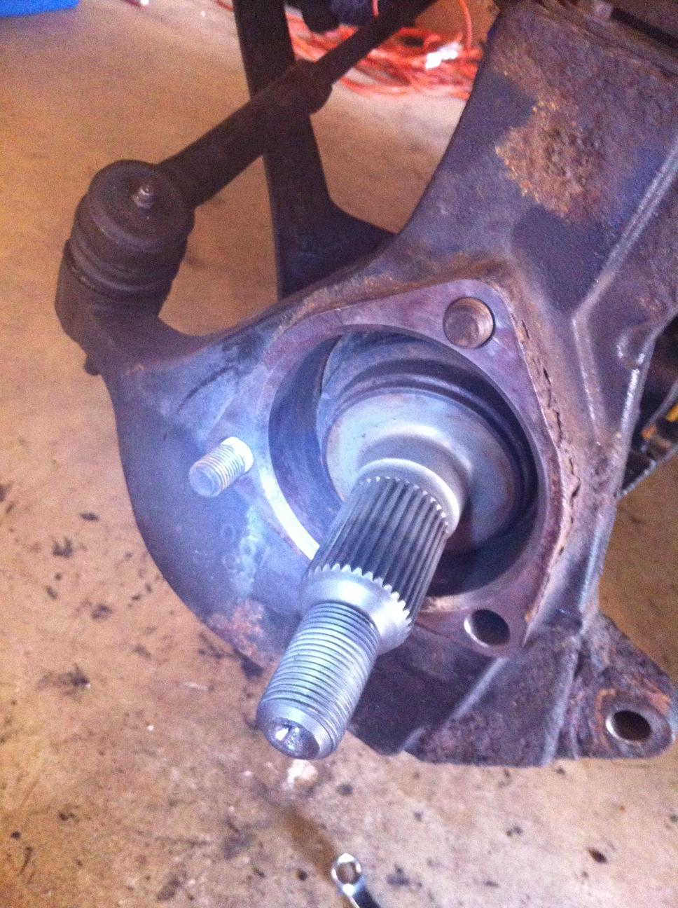

Clean things up before putting the new ones on.

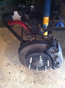

Done! I also did sway bars. Not pictured are new control arms I put on a couple weeks later
