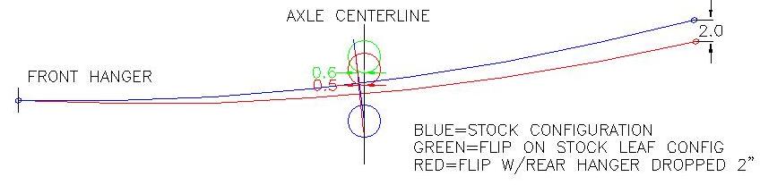

Originally Posted by BlackGMC
BTW, i had to move the spring perch forward about 7/8 to get the driveshaft lined back up. wierd because i read that most people have to move it backwards...
That is strange. I was thinking that rotating the spring by lowering the rear hanger moved the pin alignment enough to put it on the opposite side of the axle centerline so I threw it in autocad and rotated it. The 2" rear hanger drop didn't move the pin alignment enough to make a significant difference. Here is the illustration...
btw... nice work on the suspension. Makes me want to get out and finish mine. I am curious to hear the final results on ride comfort and traction improvement.

It's actually a 5" rear drop since you only altered the rear mounting points of the leaf springs. That's why the truck is sitting level. 0/2, 2/4, 4/6, etc... dropped trucks all still have a bit of rake to them.
It's a good thing it turned out the way it did though, because it looks perfect. Nice job!
