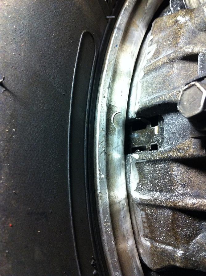

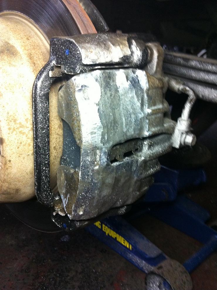

I tried this with no success. Pattern where backing plate bolts up was rotated 45* and wheel cyl sat at 3 oclock. Finally rotated rear end housing to bleed and rear brakes hardly worked. Wouldn't hold back enough to spool my turbo.
Old May 16, 2012 | 11:48 PM
stock48's Avatar
9 Second Truck Club
Joined: Sep 2006
Posts: 3,655
From: Colorado Springs, Co/ Central, Ca
Ended up doing this and it was a major bitch..
These are just eagle 15x10 4'' backspacing.
Attached Thumbnails Drum brake swap for rear bogarts-photo-12-.jpg   Drum brake swap for rear bogarts-photo-5-.jpg
