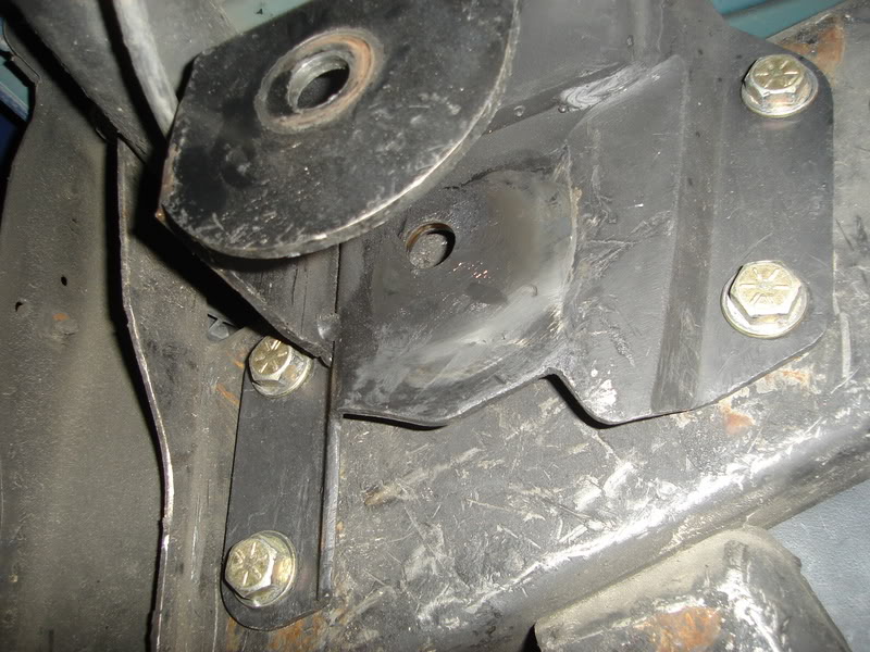

well if those won't work, the belltech ones don't either.
your going to have to notch them like this...
btw these are the belltech ones.

I have the McGaughys. On the bottom hole there is no problem. On the top hole of the hanger you have to notch it to clear the big bolt on the cal trac.
