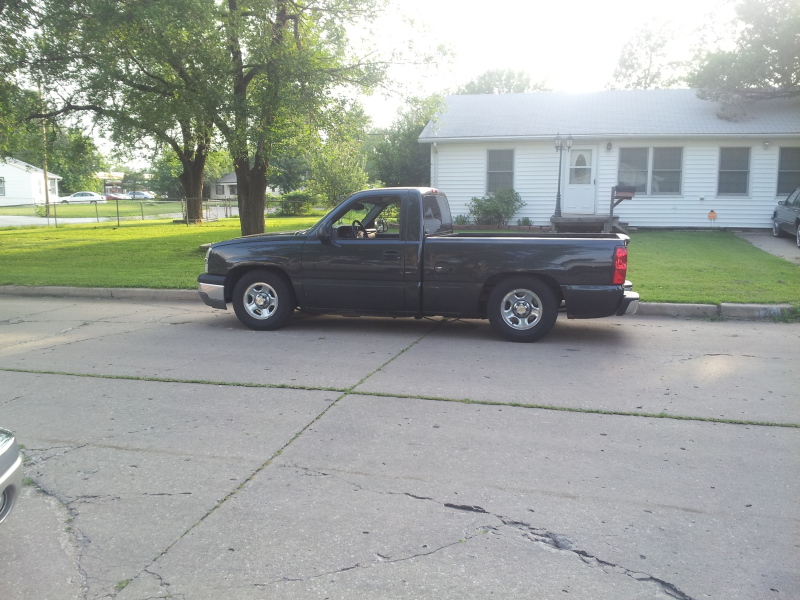

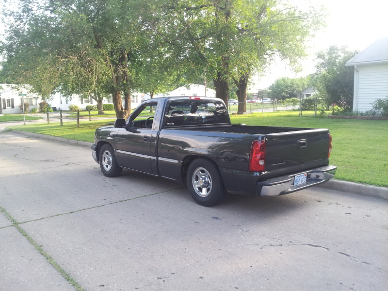

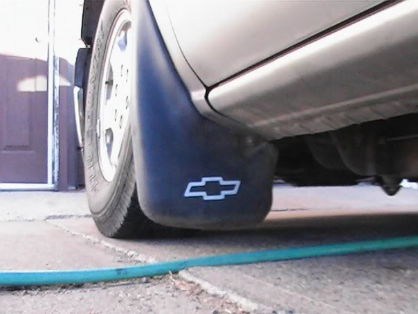

So last sunday installed a djm 4/6 drop with the 4in lower control arms up front and flip kit in the rear. The install was straight forward and pretty simple. The rear dropped as advertised at an actual 5 3/4 on both sides but the front isnt as low as its supposed to be and is actually sitting slightly higher than the rear. Ive tried loosing the lower control arm bolts and sway bar hardware while the truck was on the ground rolled it in and out of the driveway(has a 2-3 in bump at end) and let it sit for over an hour and still no change. I kept the factory springs and rubber isolators and installed new factory length shocks when doing the drop also so not sure where to go from here.
Drop measurements before/after
driver front 18.75/16.25
pass front 19.25/17
driver rear 21.75/16
pass rear 22/16.25
Any help would be appreciated

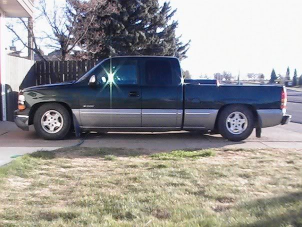

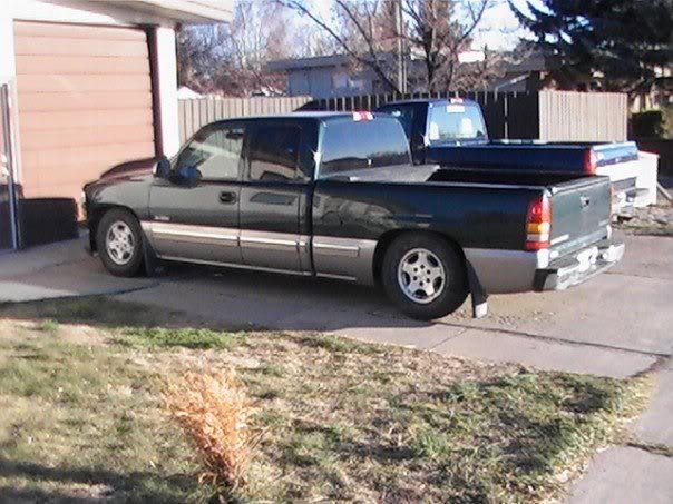

They sent you the wrong control arms. Or atleast that is my guess. DJM stuff doesn't need to settle really, you're riding on your stock springs. Here is my truck with the 4/6 drop the day after I dropped it without an alignment done yet....

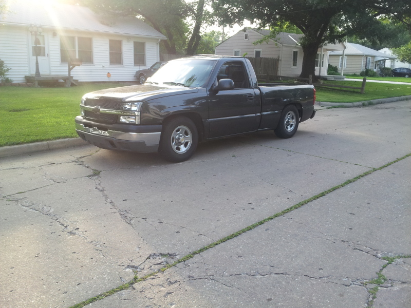

Welp got it figured out. The bottom rubber isolater wasnt letting the spring seat fully in the bottom spring pocket so pulled them suckers off and now it sits as low as its supposed to. Ended up being a 3.5 drop up front with the control arms and 5.75 in drop in the rear with the flip kit. Very happy with the stance and rides damn close to stock, didnt experience any bumpsteer on the 15min cruise I took after but well see how it goes from here.
