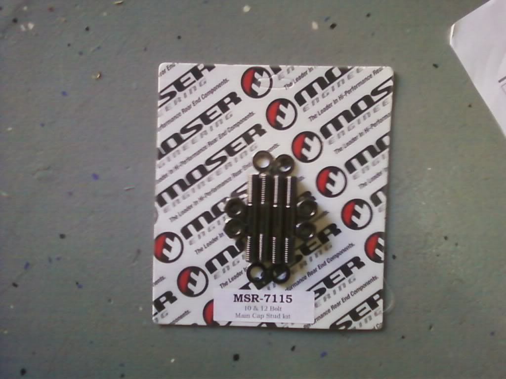

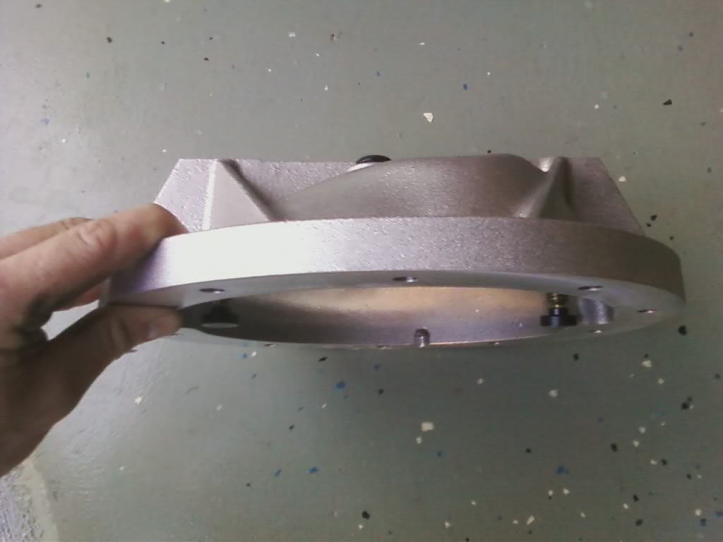

Here is mine. They are 5 mintues from where I live, I also got the studs to replace the bolts like above and they have the kits for them as well. Also I used stainless socket caps screws as they don't rust. I have had good luck and also had a smaller cover on my s10 that was the same for 5 year until I rolled my truck and then I put in on my LT1 firebird with a t-56 with 180,000 miles on it and never had a rear end problem and I know I was hard on it for about 20,000 and I mean really hard on it.

When you order from TA the stud kit is listed as a 19.95 or so option. I would recommend it as well. They are great place to deal with and nice everytime I have gone in person and or talked to them on the phone. I also added a filtermag magnet jbwelded to a flat spot I ground in the inside of the cover it was a GP 101 magnet with 20 pounds of force about 21 for the mangnet and also made in Phoenix. Since the cover was aluminum I didn't know what else to do and the factory magnet was weak, but the new one really is pretty strong for a rear end, and I added the same one to my tranny pan as well. Also the cover is really thick and it pulls the heat out like there is no tomorrow. I like that it helps to cool the rear end by acting like a heat sink.
