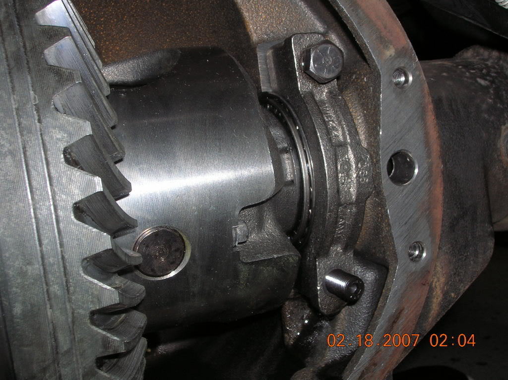

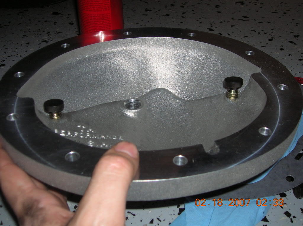

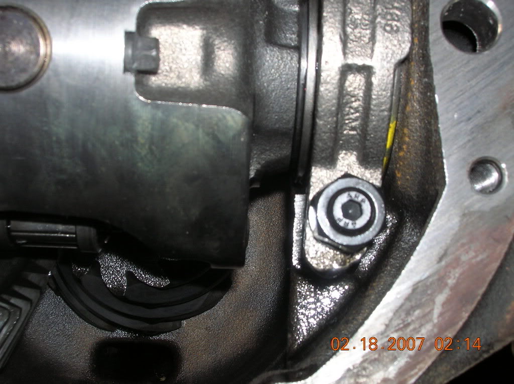

If you do run one, spring for one that has the bearing cap supports (load bolts) also known as a girdle. I use TA myself and also opted to swap out the bearing cap bolts for ARP studs.
TA rear end girdle:
Load bolts:
Stud in the lower bearing cap (no nut):
Stud and nut installed:
