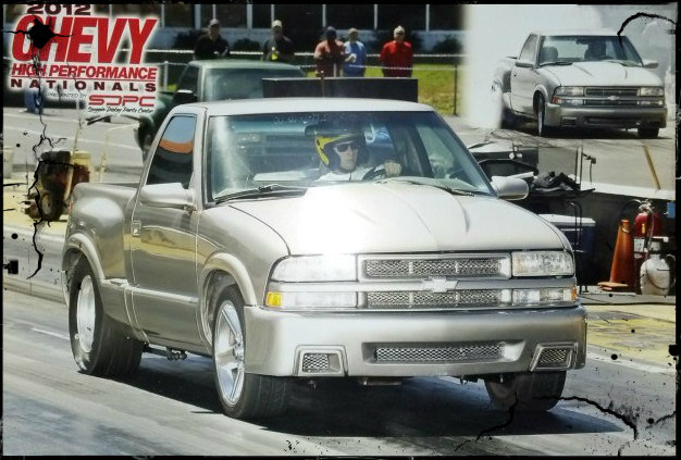

It did hook consistently this time with an average 1.85 60ft with a best of 1.79. I'll try stiffing the rear shocks and defiantly adding more air, but I have the lowering setup from Calvert only having the upper whole.
Here's a good picture of me launching this weekend: Name:  Untitled-1.jpg
The caltracs are parallel to the ground when the truck is not under load.

if you're dead hooking it definately should be doing better than 1.79. those gears must be killing it. parallel to the ground is what you want. if it hooked consistantly just up the tire pressure 2 psi per run until it loses it. then drop it back a little and go from there.
