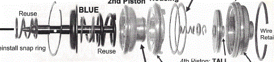

Can you explain some more about flipping 4th servo piston in the cover to tighten up the band?
What does it do to the band?

It basically positions the pin future into the transmission to tighten up the slack in the band. Basically there is one boss on each side of the piston. One is taller than the other to help accomplish this. Not the best pic but here is one that comes in the TG instructions for one of their kits.
