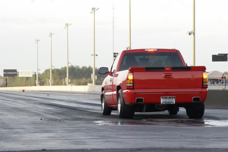

Thanks for the info, didn't know there was a simple fix. My rig has always had the lean, figured it was the fuel tank and my 205 butt on the left side. I ordered the suspensionsource.com spacer. It will be a few months before i'm home, but I'll post a updated shot and measurements.
