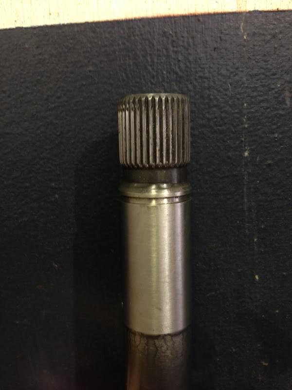

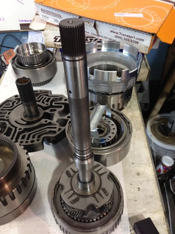

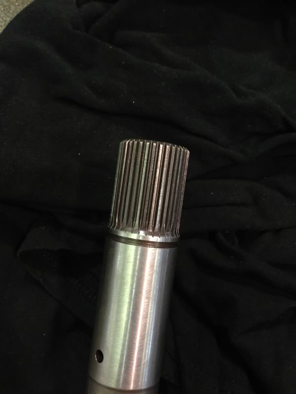

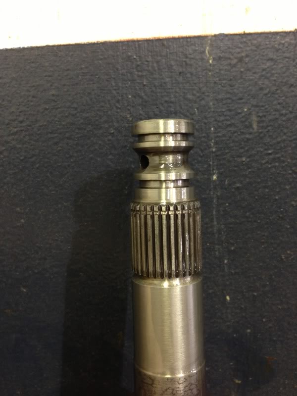

Not all billet input shafts are created equal, how the splines are cut on the ends makes a difference. Some shafts have recesses cut into them for tooling, CK's does not. Where the recess is cut seems to be the weak point.
Look closely. Stock

My CK 300m

The recesses below the front most splines aren't really the "weak point" per se, but Chris's addition of more spline engagement is a nice touch. He also removes the largely pointless undercuts which are slowly becoming the standard for 300M input shafts lately.
ALWAYS upgrade your input shaft before your main shaft. A stock main shaft can last a long time at very high power levels. They can break though, and at some point they do need to be upgraded, but the input shaft always comes first.

There are some decent billet shafts out there from several vendors now.
We've seen some that broke. I'll say they we're made in North America but not the US and leave it at that.
The CK shaft is probably a decent piece. I had some issues with CK parts quality control int he past and quit using them several years ago (5-6 yrs ago now). Like stated above, the termination of the splines isn't a weak point.
We are using some shafts now that are undercut on purpose
