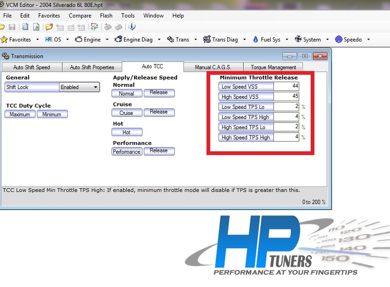

Originally Posted by lxcoupe
It basically happens at all cruising speeds when you take your foot off the throttle.

Originally Posted by DrX
Thats the one...Basically set the high speed to Zero % and lower the MPH to your liking. I have mine set to 20 mph and have my TCC tables setup to keep it locked 2-4 in Tow/Haul. Works great for engine braking with a loaded trailer.
