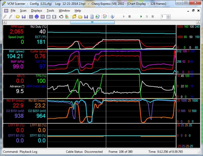

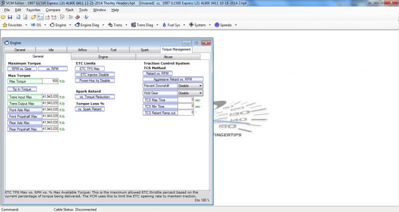

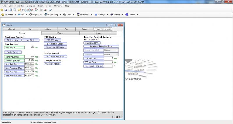

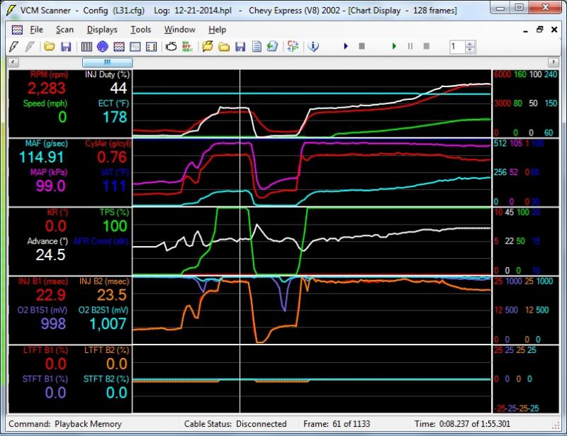

Before
After
You can see the dramatic difference in timing and the 200 rpm higher brake stall from the extra torque output.

Originally Posted by Fast355
Before
After
Fast, those screenshots look like the basic changes to eliminate torque management, am I correct? I believe entering "640" achieves the same thing does it not?
Old Jun 26, 2015 | 02:48 PM
Fast355's Avatar
Joined: Oct 2006
Posts: 642
Likes: 21
From: Euless, TX
Yea basically removes torque limiting. 640 should do the same thing. Make sure you bump up the output torque limits as well.
