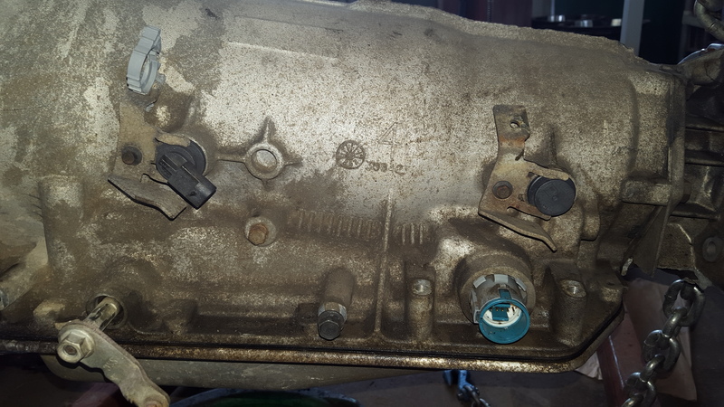

Little confused I picked up my 4l80e out of a 03 2500HD and the rear ISS sensor just had a block off plug like it was never used looks factory, I was under the understanding that all 4l80e use 2 speed sensors?

It was a 4wd then. 4wd has rear sensor on tcase.

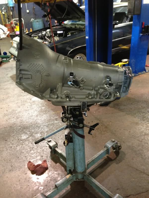

Here is mine, you can see in the picture that the rear just had a block off plug as mine is AWD.
