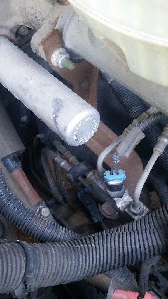

Would it be safer just to go ahead and take the factory proportioning valve out with the booster?
Old Oct 15, 2015 | 07:51 PM
1FastBrick's Avatar
Custm2500's Rude Friend
Posts: 14,614
Likes: 913
From: JunkYard
Not sure exactly what that is but you should not need it. Appears to have a sensor on it. Its possible on the Tahoe's they felt they needed to lower the pressure because of the weight difference and the shorter wheel base so they may have added a proportioning valve or a residual pressure valve.
If it's free and they are not going to charge extra, Then take it. If you feel your Brakes are not working properly the try adding it.

Thats the proportioning valve/ pressure sensor, the sensor will turn the red brake light on if the pressure is too low in the system... Tahoes seem to be the only platform they actually put that on...
Willhorne22, if youre doing this much brake work, might i suggest going ahead and getting the line kit from gm if you haven't already... Especially if your lines are rusted......
