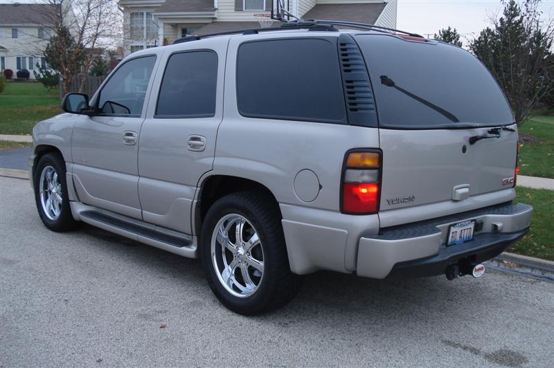

Hey how mine sit's after it air's up.
Attached Thumbnails Belltech/Denali Question-cars-382-medium-.jpg

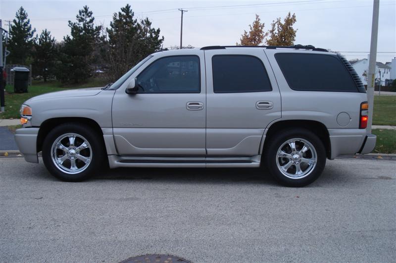

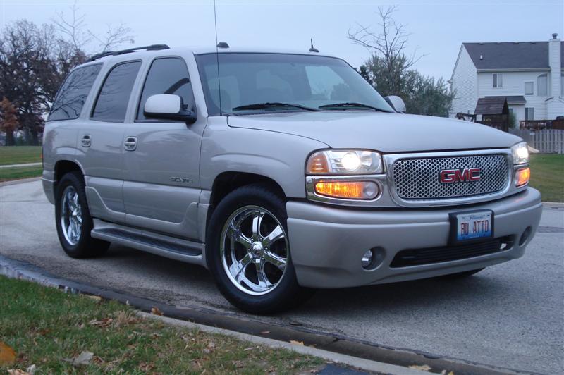

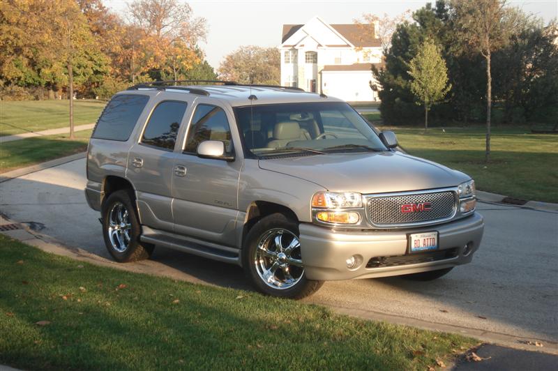

Some before and after pics.
Attached Thumbnails Belltech/Denali Question-cars-376-medium-.jpg   Belltech/Denali Question-cars-373-medium-.jpg   Belltech/Denali Question-cars-388-medium-.jpg   Belltech/Denali Question-cars-389-medium-.jpg   Belltech/Denali Question-cars-391-medium-.jpg
